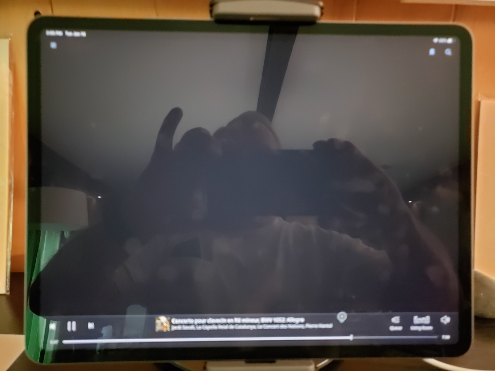

Happened again between 2 and 3 PM Jan 14. Today. Sorry for the photos, happened shortly after I responded to you last post. Need to test the screen recording feature you posted before the next occurrence.
First photo is Blurry. Had some music playing with queue screen displayed. Screen timed out. When I entered my PSW to get the screen back this is what I found, same as last 2 times it happened.
The queue screen is blank, top bar has the Menu button, Bookmark and Search buttons, no directional buttons. Progress bar across the bottom. No forward or back buttons.,
Pressed queue and the screen returned but without the forward and back buttons. At this point I’m stuck on the queue screen with nowhere to go. Have to use Menu to get back to the Overview screen.
This is the third occurrence, has only happened when I leave the display on the queue screen.
