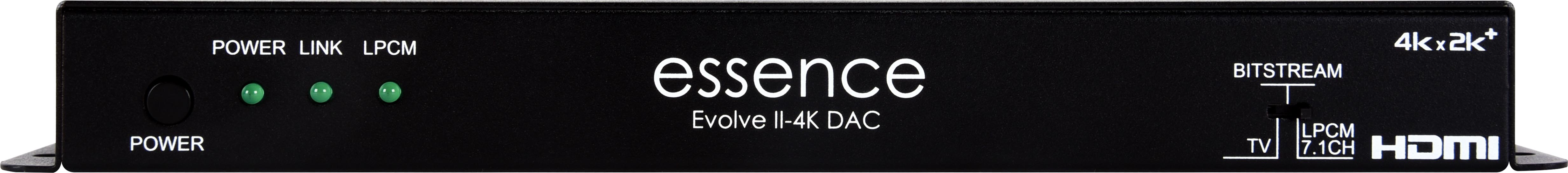

Instead it may be worth considering the Essence (Streophile product of the year 2019)
Kalman Robinson’s review here…
https://www.stereophile.com/content/music-round-98-trinnov-altitude-32-essence-evolve-ii-4k-page-2
Well, I have all three of the u-DAC8, the Evolve and the UDIO-8 at home. The UDIO-8 is the best because you can use its interface to link any set of 2-channel DACs as you please. I have 4 Musical Fidelity v90 DACs stacked for an 8-channel array in my main system. It sounds very nice. The other two I use on secondary systems and the pleasure of multichannel through Roon with them at the price is greater than their faults, regardless of reviews. Don’t be afraid to experiment. I will have my Okto Research dac8pro this coming week (after a five-month wait!) and look forward to comparing its sound to my udio-8 stack. JCR
