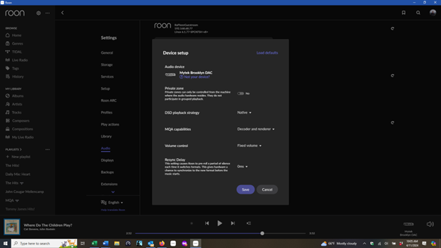

Roon user for several years. NUC based ROCK. Have three (RoPieee) RPi's feeding DAC's capable of 192+kHz one of which supports MQA. Roon is operating normally even ARC, but as of yesterday, after rebooting one of several switches in my network, all higher res files play at (Source) 44.1kHz 16-bit resolution only instead of their native higher resolution or MQA format. This applies to both Tidal streams and my purchased HDTracks music. Is my loss of high resolution capability a NUC, network or other issue? Thank you for your help!
If this affects only Tidal, it’s probably a known issue caused by Tidal unifying their subscription tiers as of yesterday. Roon (any apparently also other clients) need to make some adjustments.

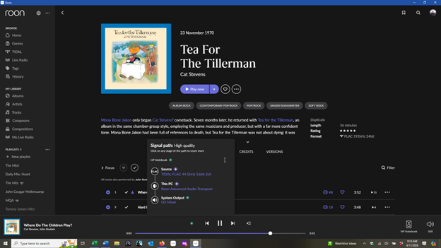

Doesn’t look like you’re connected to one of your Ropieee’s zones, but rather to the remote PC’s system output in your screenshot, no?
If so, switch to the respective zone and repost with a screenshot of that depicting your problem and also show screenshots of the respective zone’s device setup.

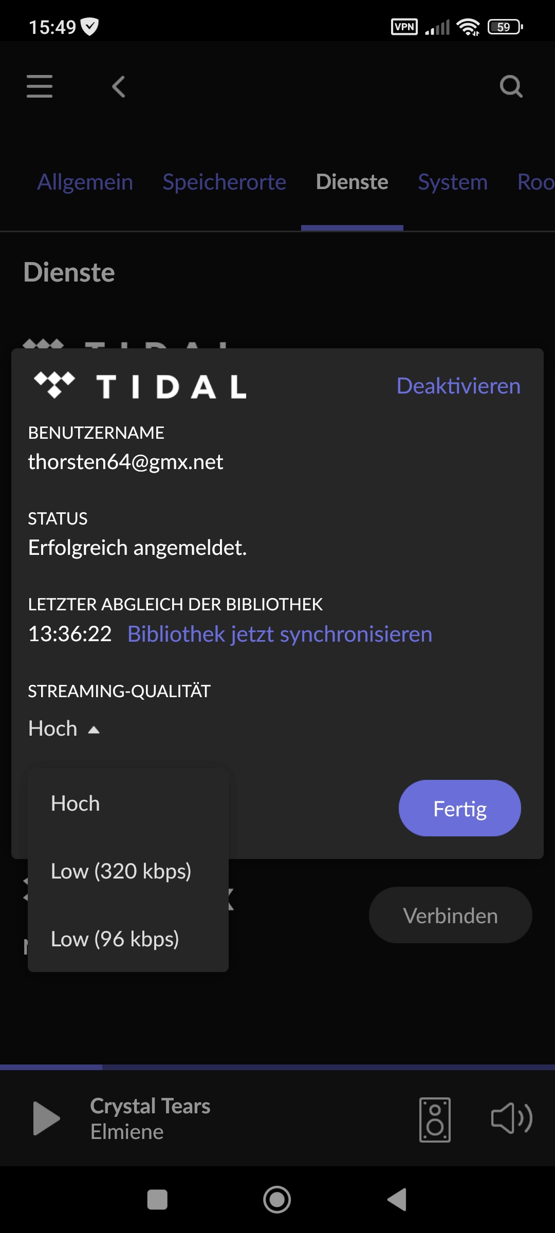

There is no max displayed on Tidal in Roon. Only up to High

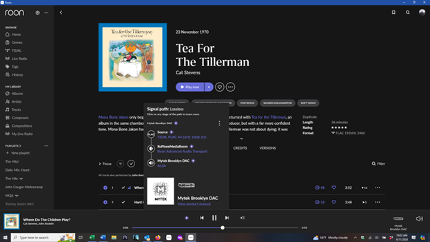

Here are pics of my Mytek DAC zone using a RPi based Allo USBridge. Hard to see but album cover area shows 192kHz 24bit whereas the Signal Path popup reads 44.1kHz 16bit. I thought this was a purchased album from HDTracks, but the Source clearly says Tidal. Maybe this is the Tidal issue Roon is working on like Suedkiez mentioned above. Thanks a bunch for your thoughts!
