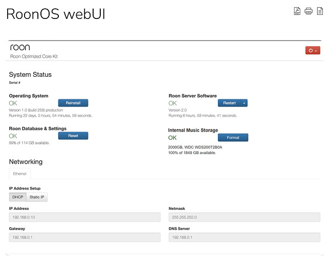

Thanks for the update! Could you next please share a screenshot of the webUI of the Nucleus?

Hi Benjamin. Is this what you are after:

Hi @Dave_Grimmond,
Thanks for sending that over! Everything looks good to the end. Let me know how the other troubleshooting steps go :+1:
