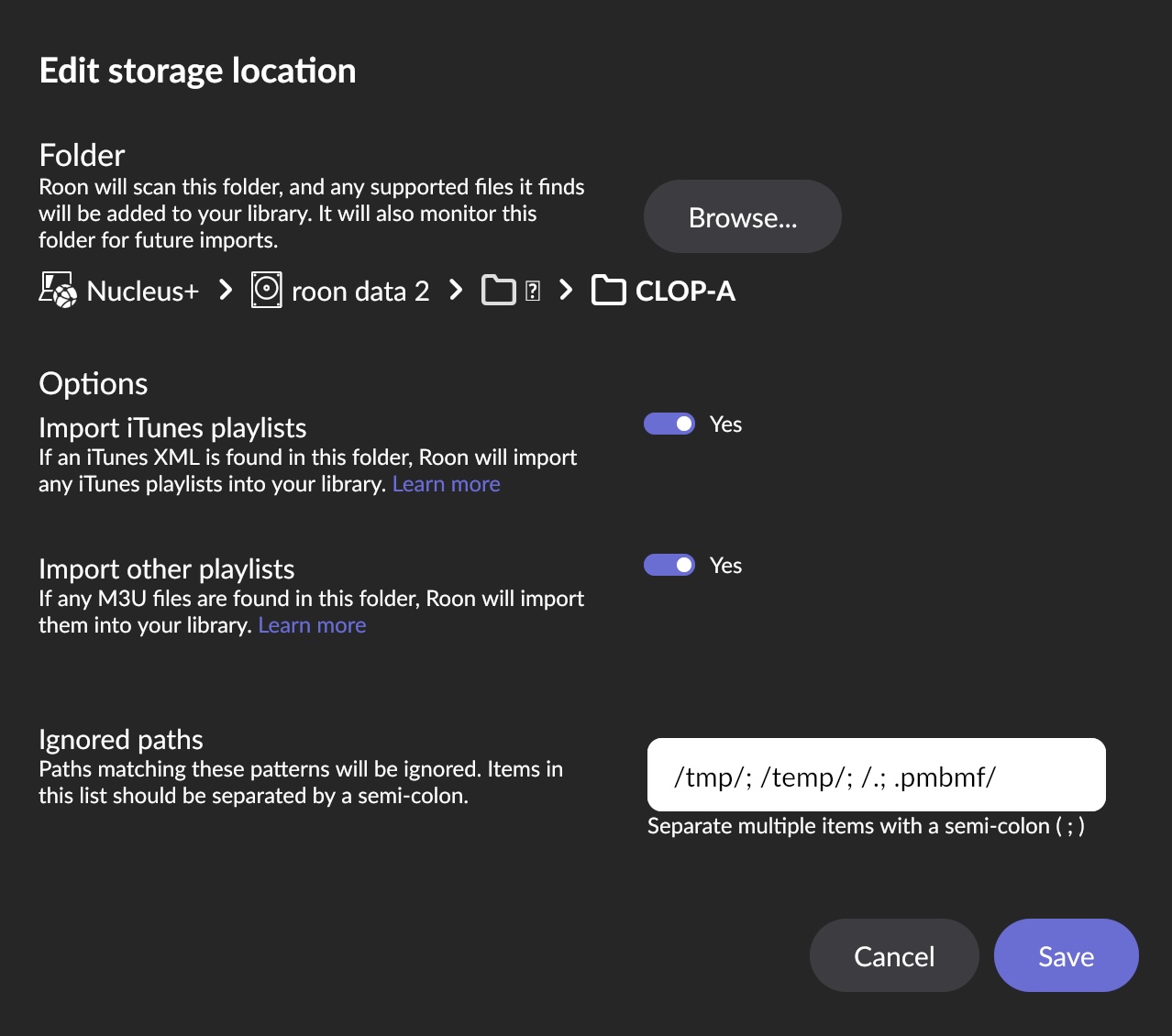

I’m still not getting m3u’s to work. Here’s the current test:
#EXTINF:0,03 - Voices, for string quartet; Blitz -.flac
H/Higdon, Jennifer/Piano Trio - Voices - Impressions/03 - Voices, for string quartet; Blitz -.flac
#EXTINF:0,03 - Hungarian Rhapsodies No. 2, Lento a capriccio.flac
L/Liszt, Franz/Hungarian Rhapsodies [Brendel]/03 - Hungarian Rhapsodies No. 2, Lento a capriccio.flac
and a screenshot of the storage config:
If you have any thoughts on this, I’d be grateful.
Thanks
Hey @Akimo,
I’m sorry that you’re still having trouble. It looks like there could be a prohibited symbol in the name of your third folder in the path. Is anything in CLOP-A being imported successfully?
There are approx. 800 albums in that directory. I’m pretty sure 100% of them are being imported successfully. Is the dash symbol prohibited?
