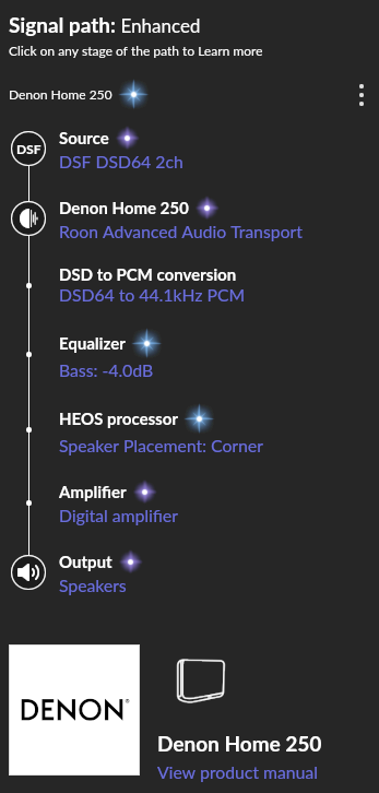

Looks like you’re feeding it 44.1 as the source to start with so it doesn’t have to downsample (unknown if the 250 does like the 150 seems to be doing). Can you send it something other than 44.1 and see what happens? The bitdepth doesn’t seem to matter - the 150 doesn’t reduce the bitdepth to 16bit if it’s sent something larger. If you send it something more “hi-res” like 48kHz then the downsampling will be listed below the Denon Home 250 entry. Like this for my 150.
Stopped working even with a freshly installed ROCK sync lost again. Looks like it’s the Node 2i rather than the Denon. I replaced the Node with a RPi4 running HifiBerryOS with their DAC HAT - which has Roon bridge build in - and there are no sync issues at all.
I agree. I can’t tell the difference between 44.1 and 48/96 etc on my 150. So I certainly can’t tell the difference with the Denon doing the downsampling vs MUSE doing it. However with the pricier devices I think I’d feel a bit cheated knowing that whatever I’m feeding it from my “hi-res” sources is just downsampled anyway. However at least it doesn’t compress the bit depth.
Ah, yep, most of my files are ripped physical media . . . I have a few high-resolution albums. :woman_shrugging:

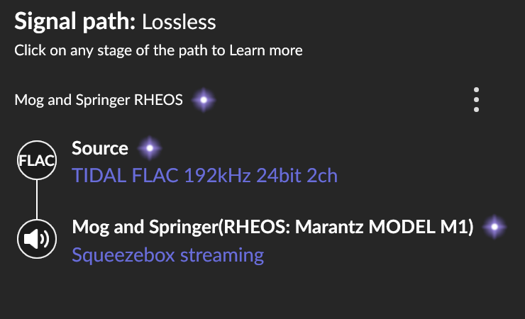

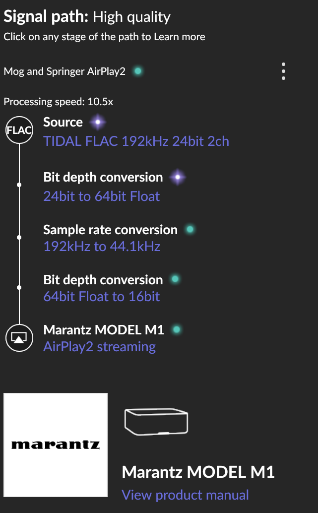

Yep. So it looks like the Home 150 and 250 devices down sample to 44.1. But they do preserve bit depth. Wonder how far up the premium ladder this goes? I suspect the whole “Hone” line does incl the 350 and the Amp but only a test will tell. I would hope the £1000+ devices don’t. An interesting one would be the Marantz M1.
Here’s the path for the M1 using ROON ready:
Here’s the path using RHEOS on the same device with pass thru chosen
Here’s the path using AirPlay2
