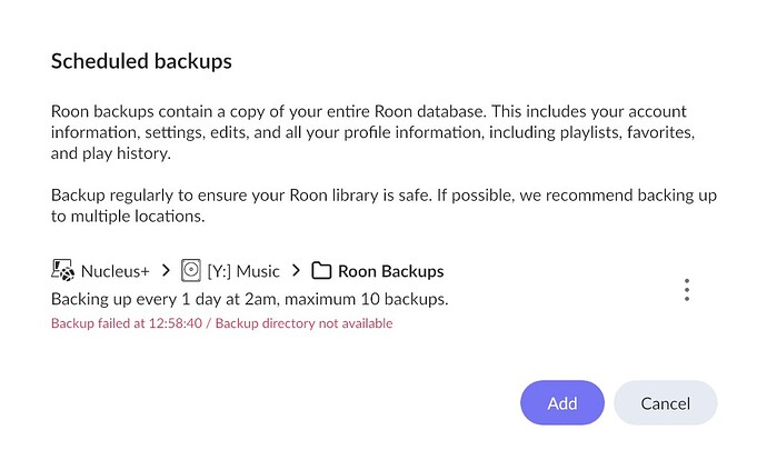

Actually Benjamin, now I have a new problem. I installed Roon Server on a PC and ran the backup file from the Nucleus for the install. Now I can’t change the backup directory on my PC version of Roon. It still thinks it’s running on a Nucleus and I don’t see how to change it’s mind…

Did you try clicking the three dots shown in yor screenshot? It should give you some options. “Edit” should be one of them. You should then be able to either reassign the backup location or delete the backup entry in order to create a new one.
Thanks for the thought, unfortunately the Edit options are only “downstream” of “Nucleus +”. It interprets the directory as not available even though the rest of the string is correct.
That’s odd - the “Choose folder…” screen in Roon should be showing you the contents of your PC file system, now that Roon Server is running on your PC.
Can you post a screenshot? Thanks.
