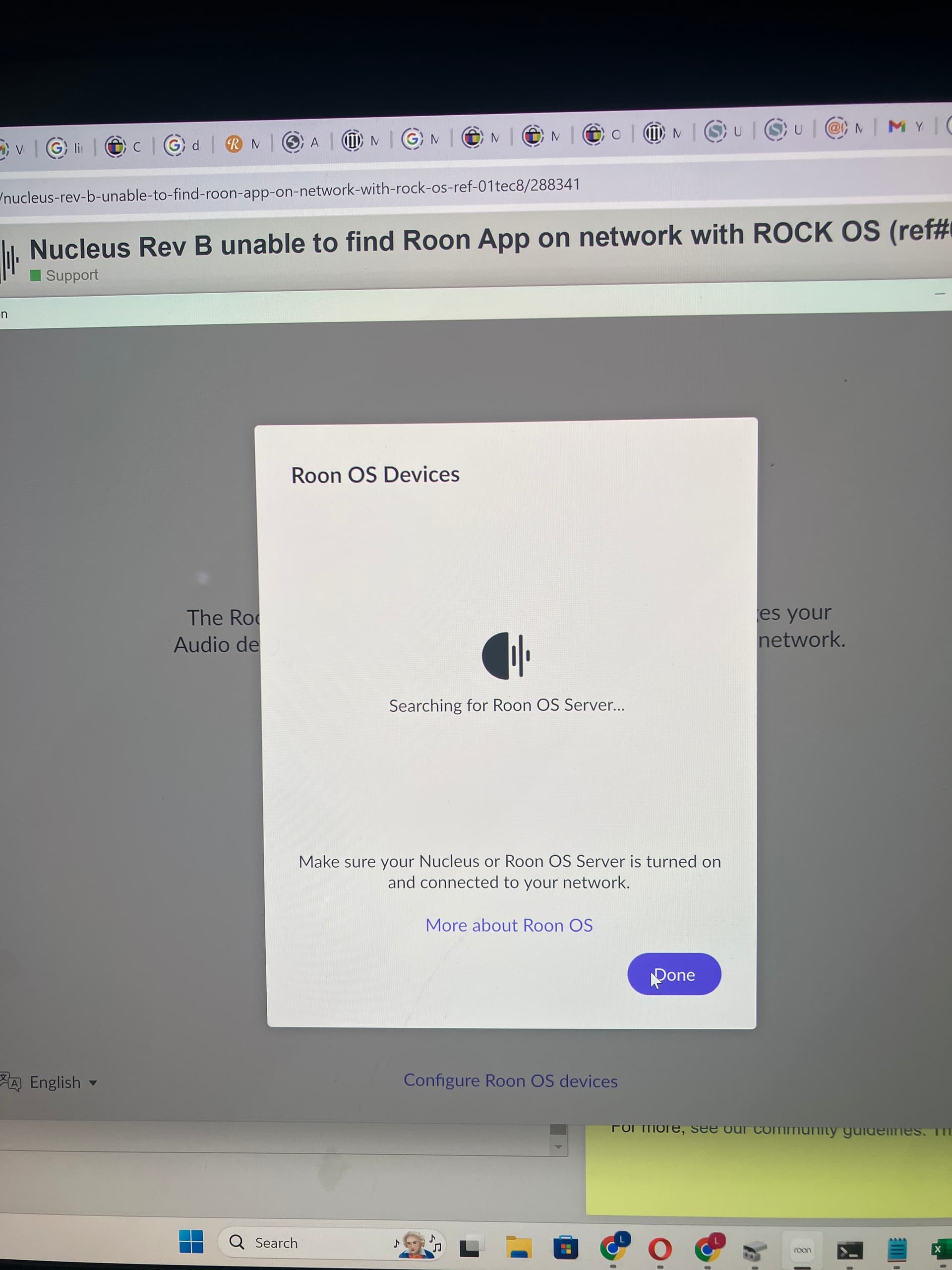

Nucleus Rev B unable to find Roon App on network with ROCK OS (ref#01TEC8)
Is Roon Server running?
· "Looking for your Roon Server"
Please try to restart your Roon Server by closing the Roon app in the taskbar or rebooting your Roon Server machine.

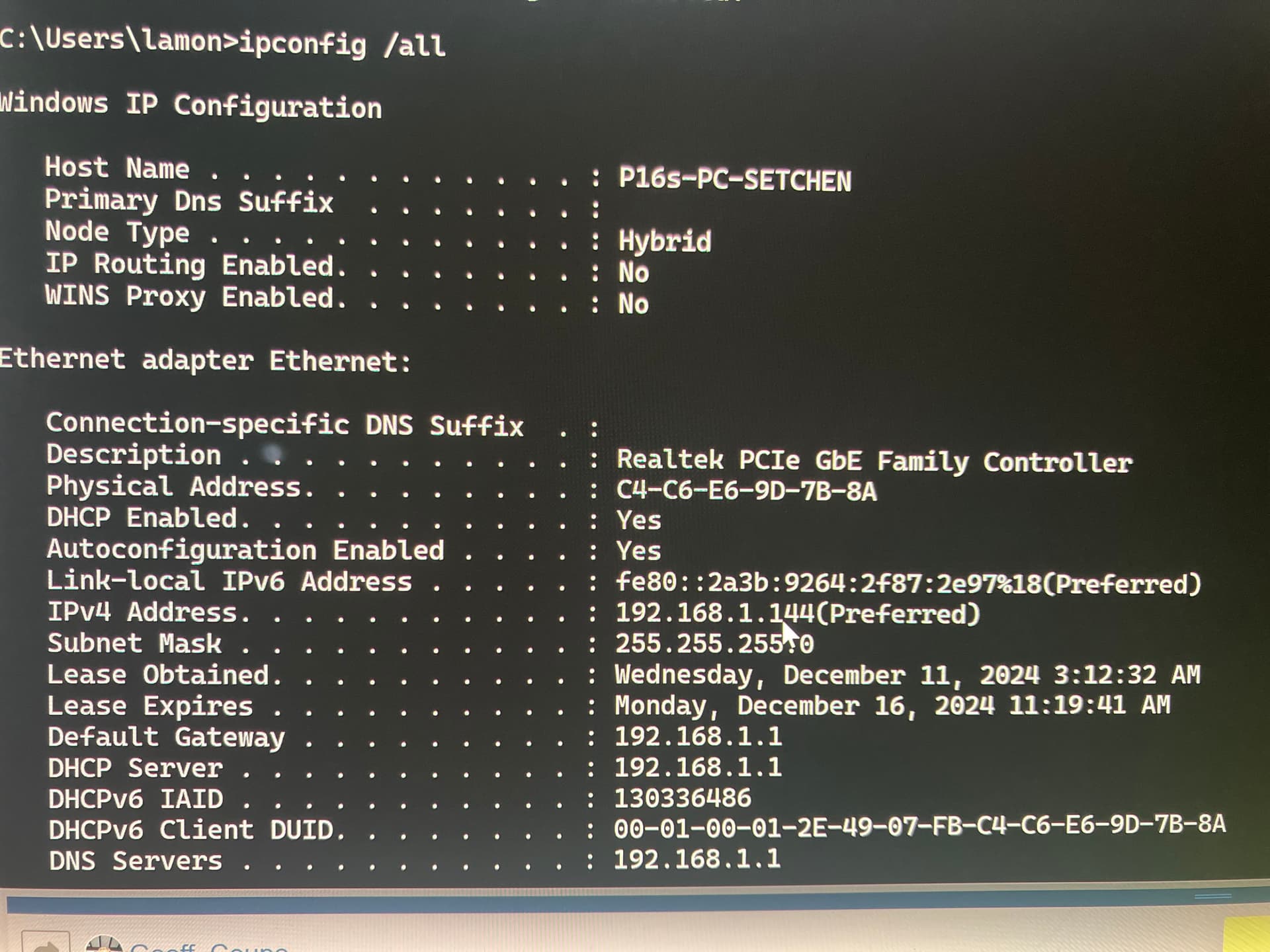

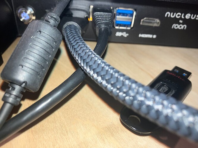

Connected to single Desktop FiOS Router same subnet IP Subnets same, all FW disabled, Using tested/verified Cat6A cables directly connected to FiOS router (Latest HW from Verizon FiOS) all Firmware/OS Patching is current, All/any other devices work soundly - Gigabit Internet, no issues Bandwidth/Latency - Never attached to WAPs/WiFi disabled entirely no VPNs or Switches/Gateways on the network.

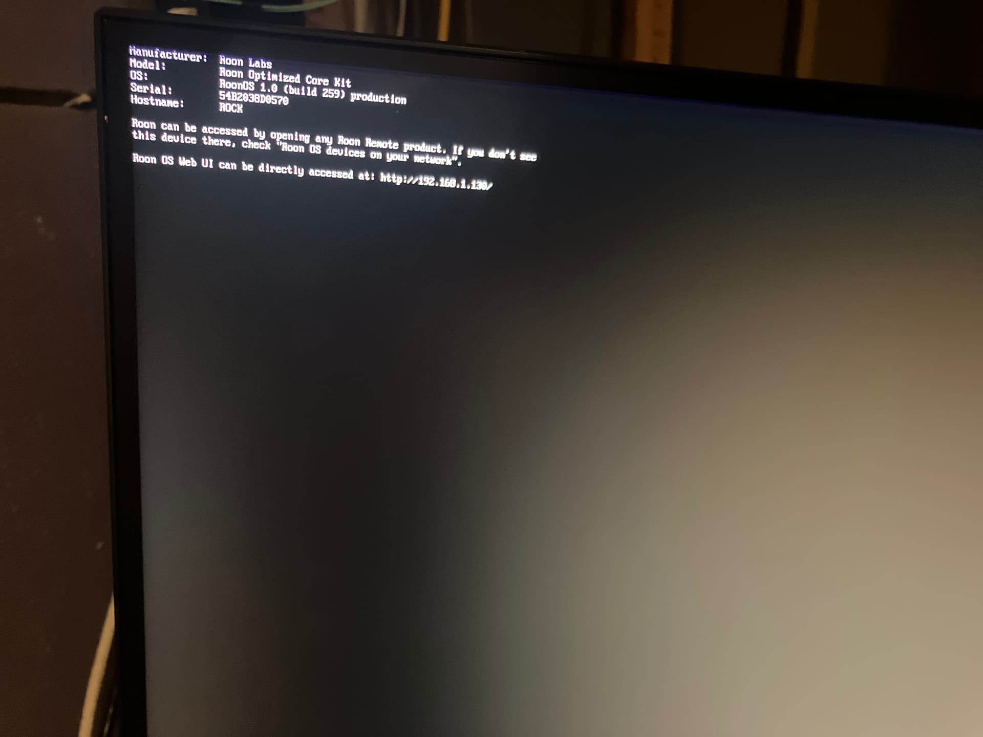

I do have a monitor attached to my Nucleus RevB. - No UI, no anything really.
Here are a couple screenshots. attached to the email.

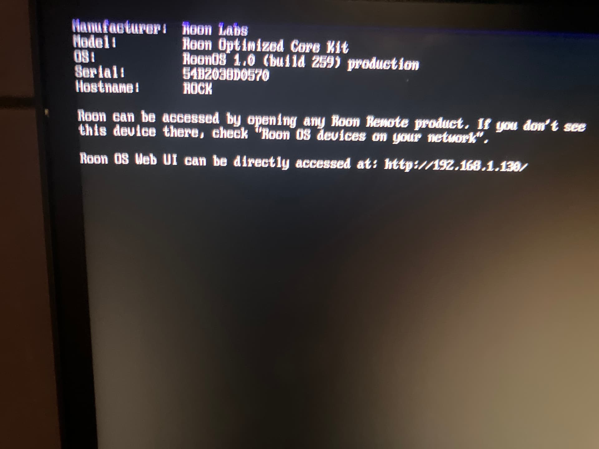

  2. Booted/Recovered via the USB stick and the screenshot is all that I get - a running server, invisible / inaccessable to my RoonApp (phone, PC, MacBook, Linux workstation) all via CAT6a (verified-working) S/FTP cables. :frowning:

If you did follow the Nucleus Recovery instructions and performed a recovery (NOT an “Install”), then your second and third screenshots are showing that something is wrong. Your model is displaying as a ROCK system, and it should say “Nucleus”.
This is usually a sign that the m.2 SSD is faulty and needs replacing.

It is strange that it looks like ROCK has been installed and is operating as expected. I am looking over your account diagnostics and it looks like the Nucleus is nowhere to be seen, which is not too atypical if you haven’t been able to log in.
Did you perform the recovery or the install option? If you did recovery, give install a try, we can perform a remote update on the unit back to Nucleus firmware once it’s online and you’re able to sign into it again.

Still no UI, Admin GUI, No valid namespace, etc resolves for me & RoonApp cannot locate Nucleus.

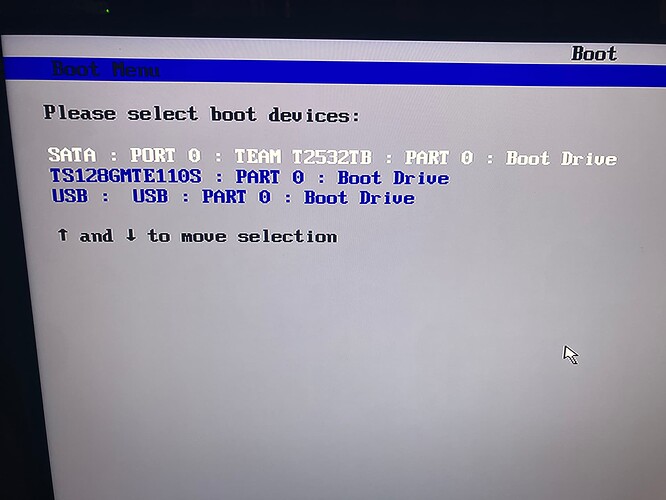

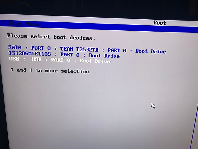

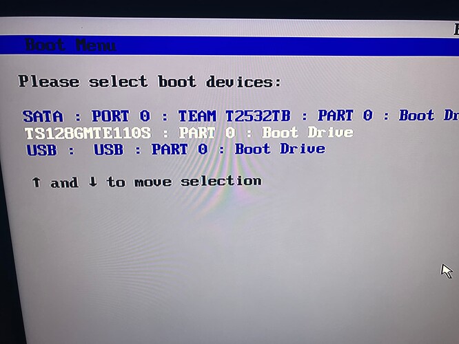

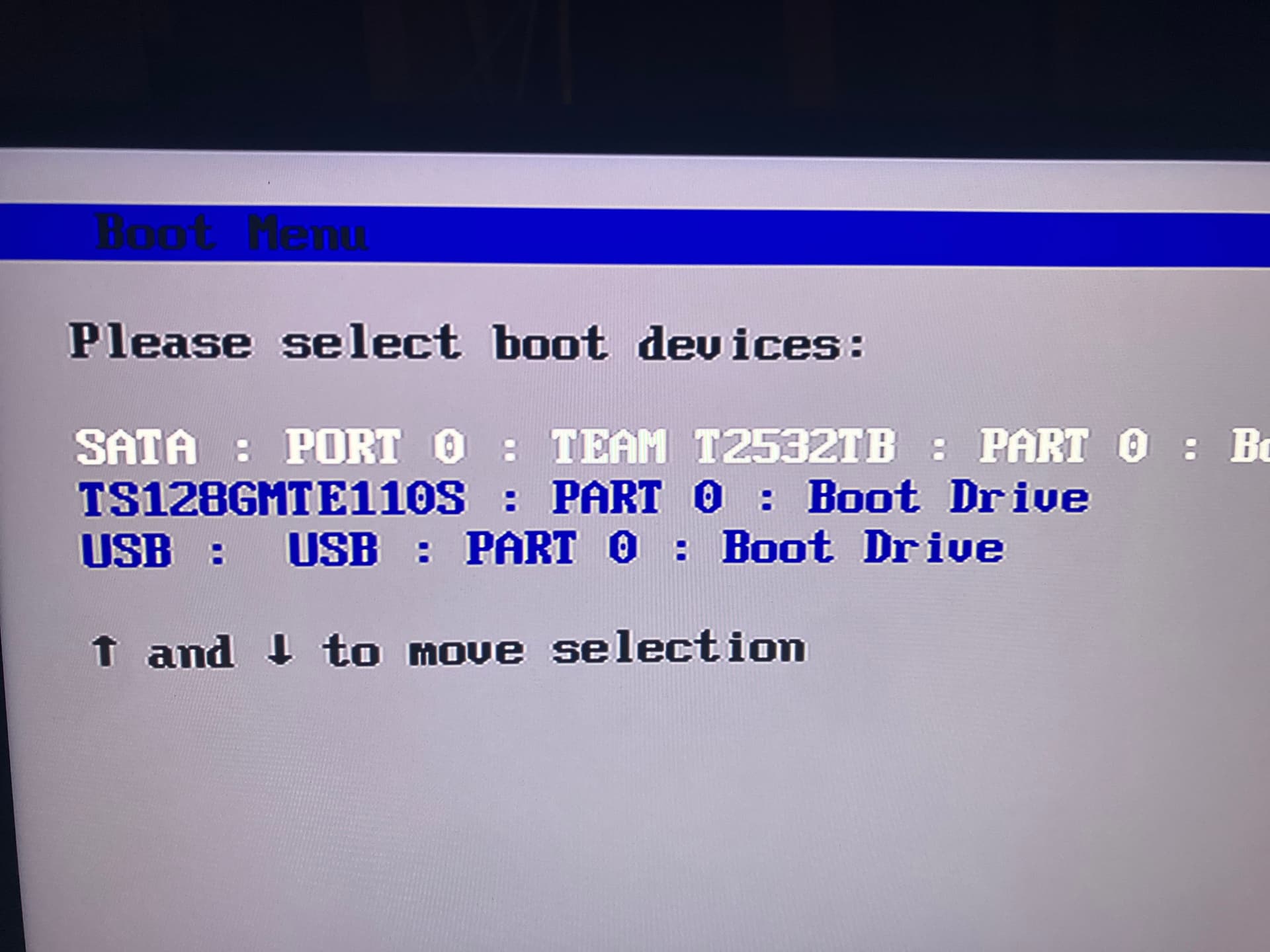

When attempting recovery USB - I do see/get the following on the prompts (See attached Image)
  • I did re-perform the Flashdrive creation and recovery steps.
  • I have also order replacement SSD - ‎Transcend-TS256GMTE110S & RAM: Crucial RAM 8GB DDR4 2666 MHz CL19 Those will be here in 3 days time, so I will be looking forward to providing updates at that time.

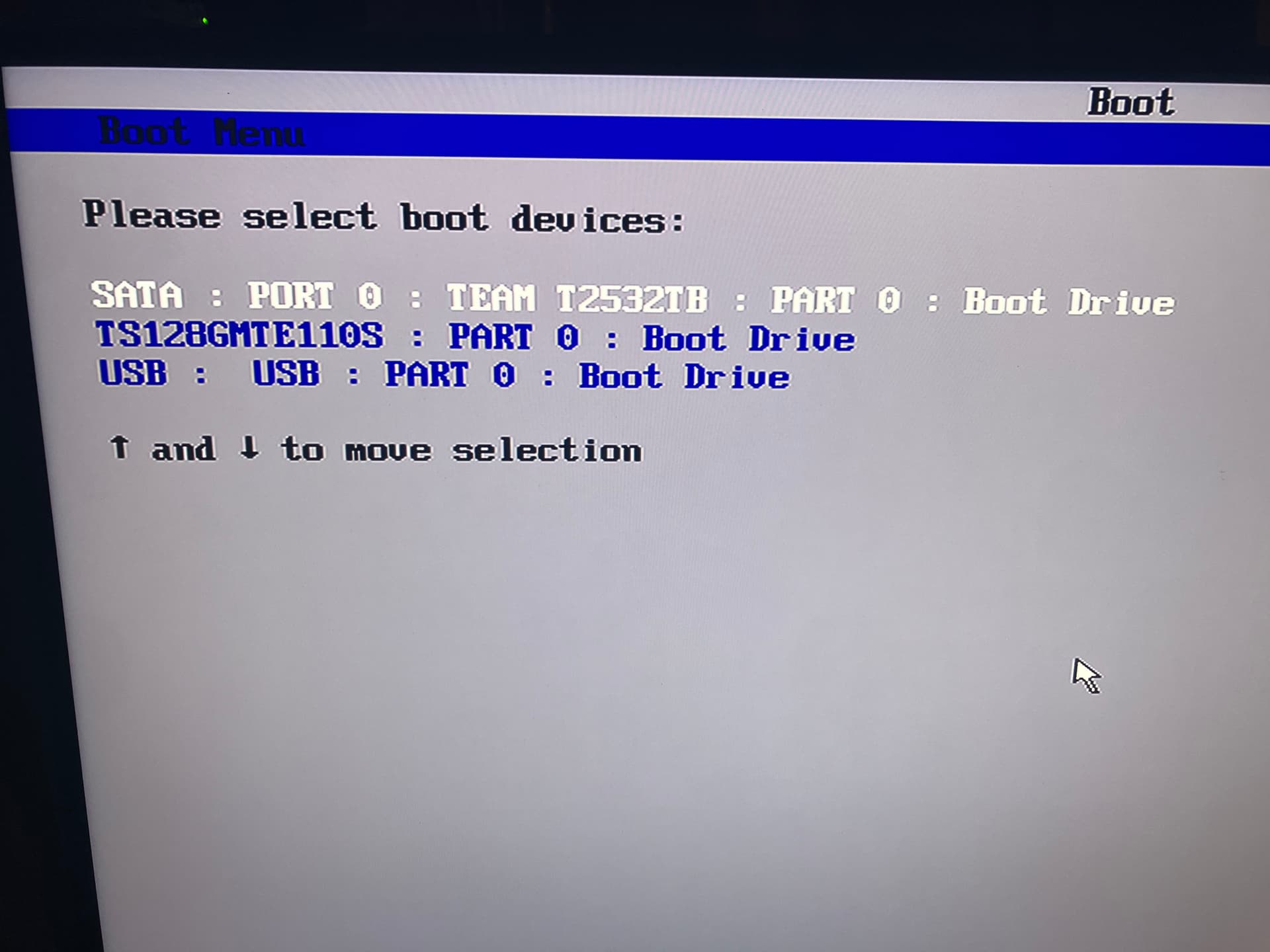

  • See attached Pics of my Bootstrap Options - Install & Recovery options not present… An issue w/the USB itself or Image perhaps?

Back again after replacing and re-trying to restore/recover the Nucleus w/new SDD and RAM.
it seems the SSD was damaged severely.
I will say booting into Visual BIOS window/utility was more challenging than I expected. Otherwise swapping the internal storage did the trick. IDK if there is a different readme/KB article that covers this process a bit more? (Something more recent - for newer Windows/iOS platforms?)
