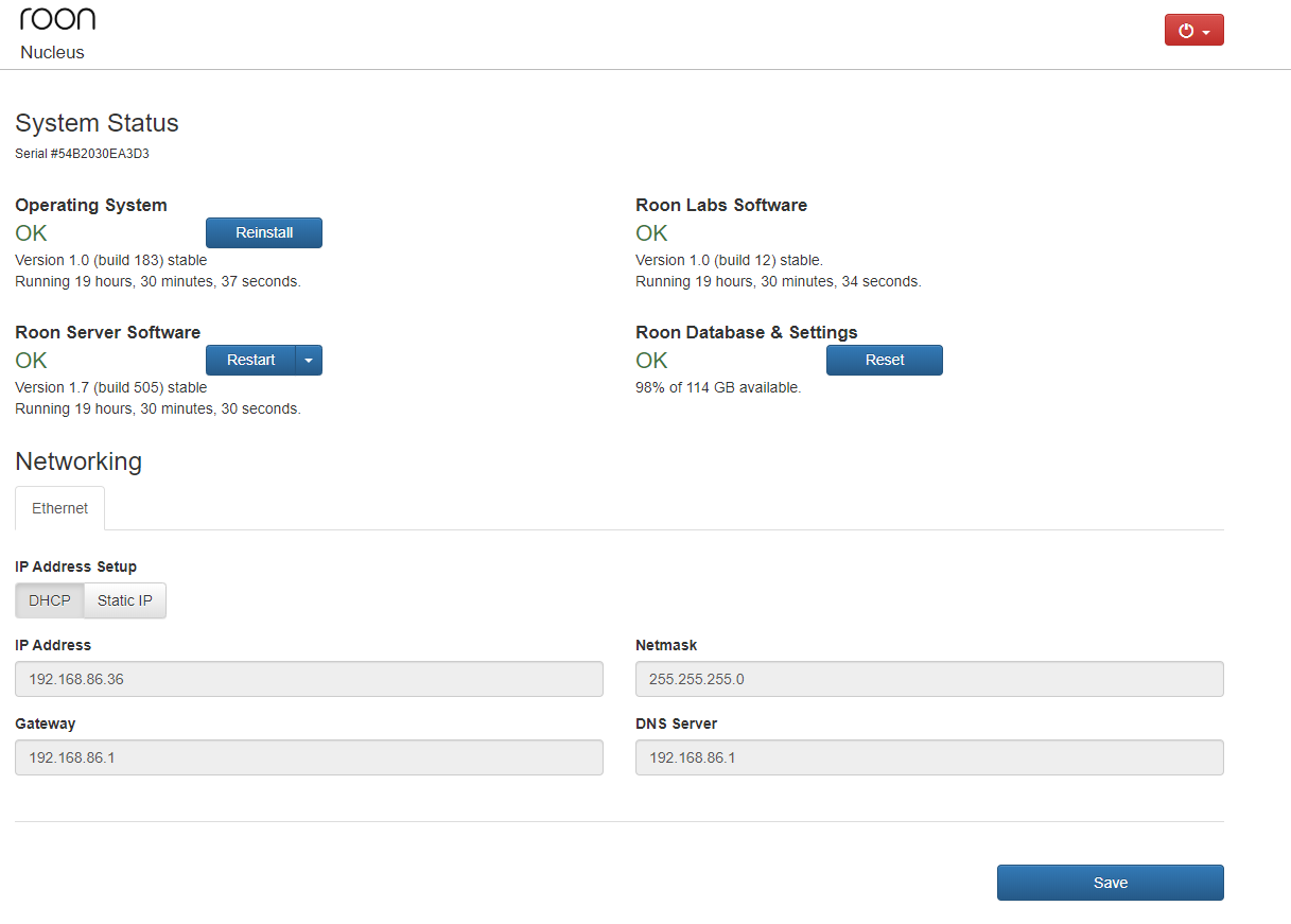

Hi @Richard_Lane,
Can you access the Nucleus Web Administration Interface when from the laptop? If so, can you share a screenshot?
Hi. yes i can. screen grab attached.
The web page does not show an internal drive found. Are you sure it has been installed correctly? I would verify that the computer’s BIOS can see it, and if not, then check to verify that the drive’s power cable is correctly attached.
