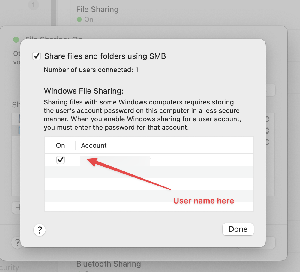

In other words, you:
1 - set it up in System Settings > General > Sharing all the way to the parent folder in question
2 - make sure your Options (top right of that dialogue) looks like this - that’s right with Windows Sharing:
Can you get anywhere close to that, Christian?
