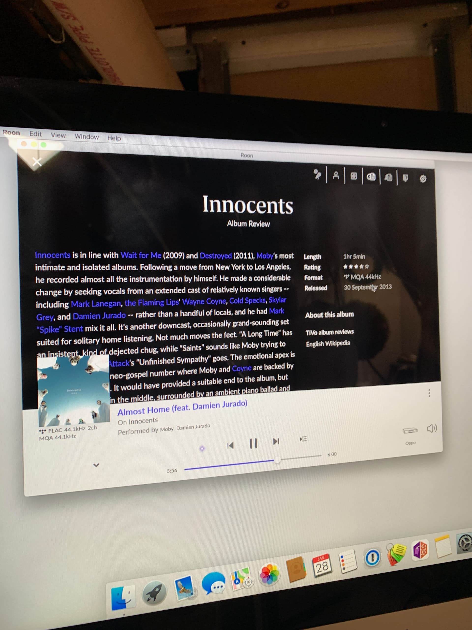

I have a fully functional late 2013 iMac that was just collecting dust. Got Roon installed and running using my old late 2013 iMac and a display port to HDMI adapter routed to my Oppo 203 input. Have a Marantz a7705 as my processor. I can get sound out and video but I’m hoping for a better outcome regarding the video aspect.
I thought that the display would mimic what’s showing on the screen of my iMac but my vidoe is only displaying a picture of the album art and the track info. I’m hoping that I have a setting not configured so please point me in the right direction. Thanks in advance.
If I’m understanding what you expected/wanted, a full image of the Roon UI, I don’t believe that is available with the HDMI output from the Roon application.
Ok, Is the 1st screen shot the best video I can get with how I have it connected? What are my other options because I like the look of the display on my iMac, but the display on Oppo is lame. I’m still trying to understand how all this works.

The Roon display by HDMI is what you get in the first picture.
If you want the full Roon UI mirrored to the TV, you can use Chromecast on Android and Windows or system AirPlay on Apple devices to mirror the whole display. The receiver will need to have a way to receive this. (E.g., built-in Chomecast or a Google Chromecast device, or an Apple TV)
As you seem to be using a Mac, AirPlay it is. No idea if the Oppo can receive AirPlay video.

The two screenshots you show in your opening post are:
As you say, the display device version does not have the features of the control device, i.e. these options are not available:
A display device, currently, is simply that; it does not have the possibility to take user input to switch the display to show different elements.
You can always raise this as a feature suggestion in the Feature Suggestions category of the forum to register your user case for this feature.
