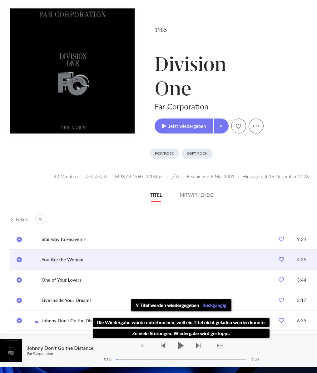

Playback errors and stopped playback on Roon with Synology server and Cambridge CXNv2 (ref#9KAGN2)
Affected Product
Roon
Roon Issue Category
Playback
Too many errors Playback stopped
Roon Server Platform
Linux (NAS/SonicTransporter/Antipodes/Ubuntu/etc.)
Linux Server Type
Synology
Roon Server Specifications
Synology DS1621xs Roon-Server by Christopher Rieke Version 20220216
Cambridge CXNv2 (7a)
Home Network Details
Ethernet
Screenshot
Hello @Michael_Herzog and welcome to the forum.
Is it only MP3 playback that fails? Does FLAC work? Did you install the ffmpeg codec into RoonServer on your NAS?
Installation instructions are given on the project’s homepage.
Hello BlackJack,
thank you for the answer,
The error only occurs with mp3 files. I have no idea how
to install ffmpg on my synology. I am not that familiar with linux…
i don’t get the Installation instructions given on the project’s homepage.
best regards
Michael

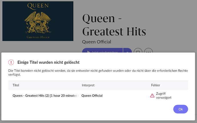

Unfortunately, I can no longer delete anything from my Roon database
which acess rights i have to provide now?
Use the information from the post above to check. From the words of the package author though, you should not need to change anything as setup wizard already set the correct rights for your selected music folder.
ok now it works, i provide the internal Roon-Server read/write access on my music folder
