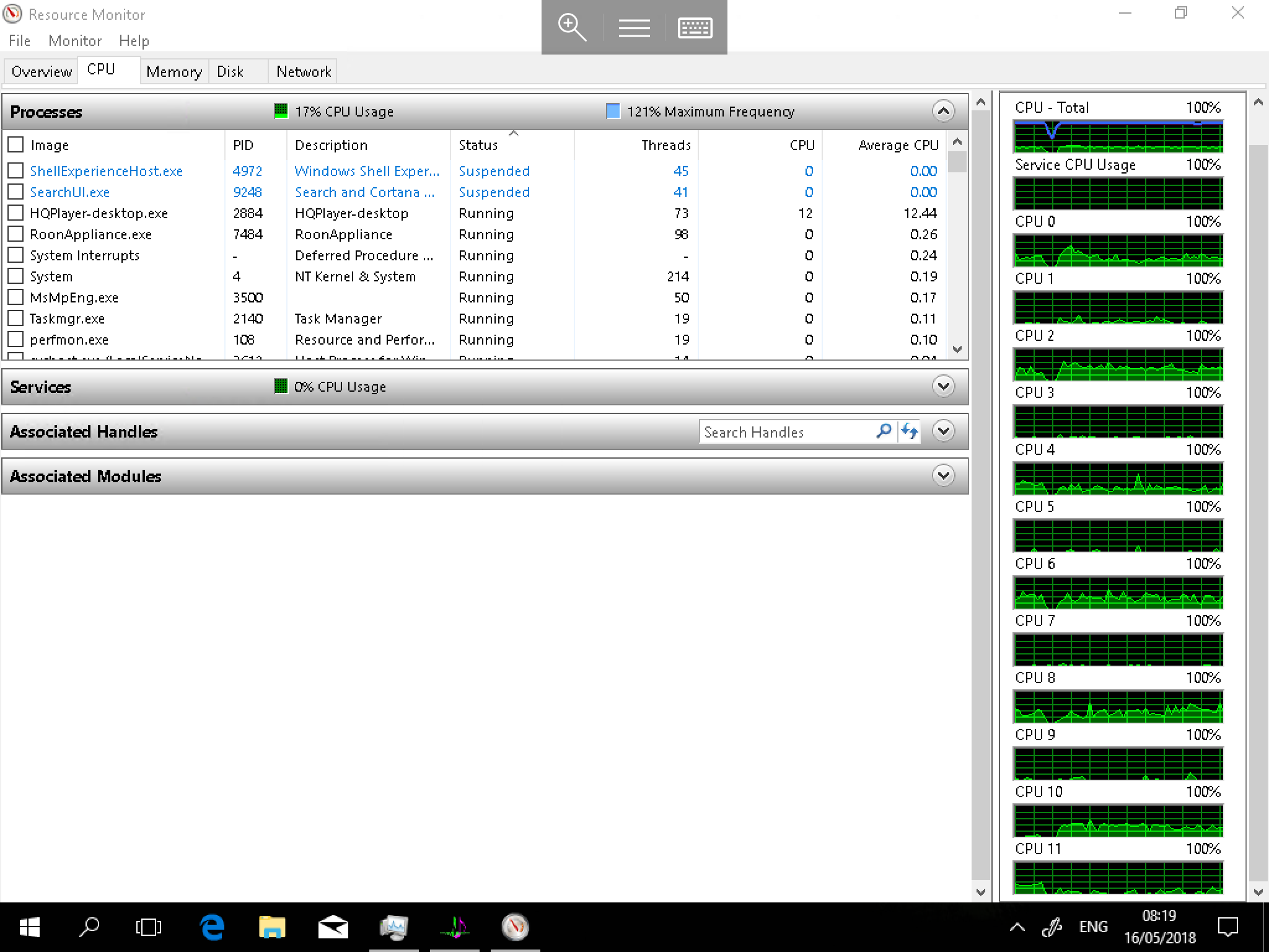

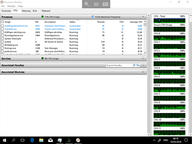

Ha. Are you able to see loading of each individual core on your machine? I saw earlier, that overall usage is low when youāre getting pops, but what about individual cores?
Is this the sort of thing you mean?
This is playing Crisalide with poly-sinc-short. (No pops -at the moment).
.sjb
Yep something like that.
