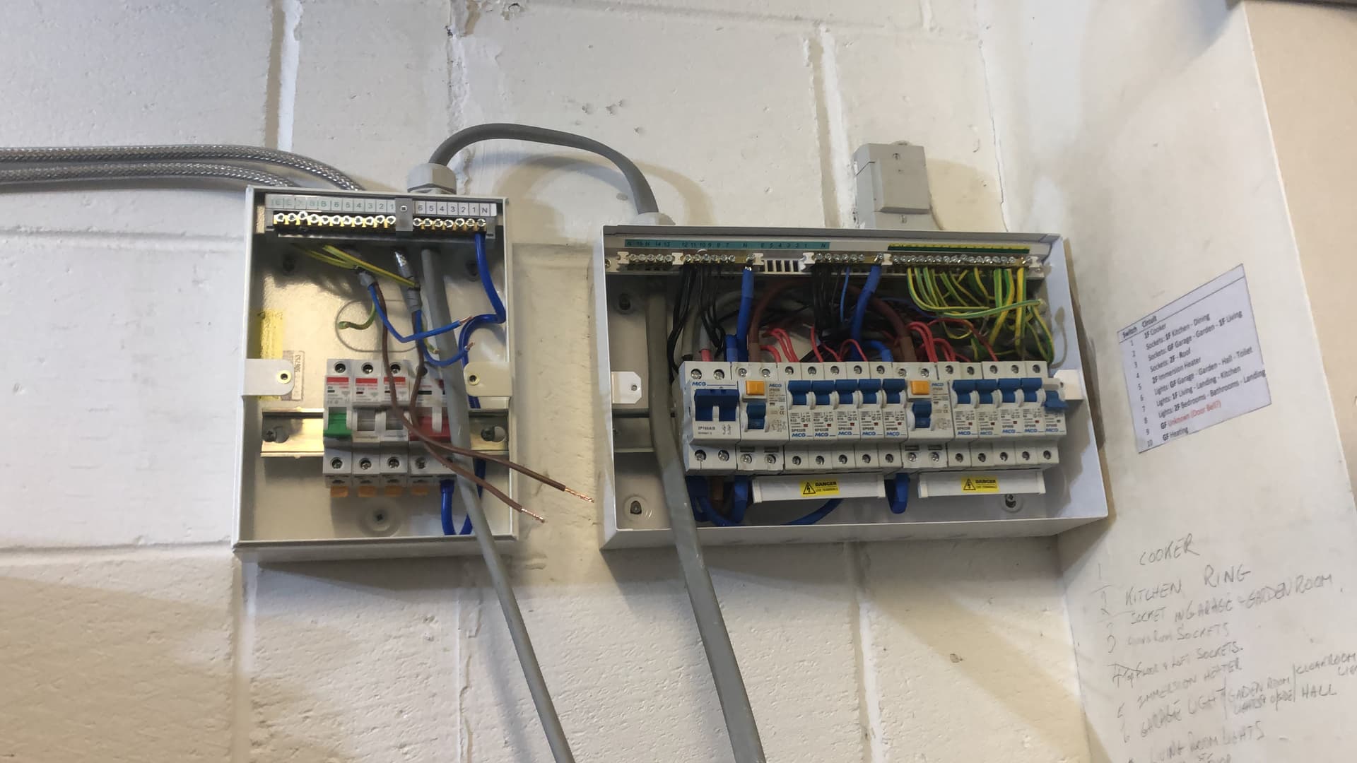

I had to have the extra box installed on the left
It’s a slave unit from the main - so I’m now considering getting a feed directly from the meter, minimising any ‘contact’ with the rest of the house wiring - so the extra box may be a blessing in disguise
That will cost about £160 all in

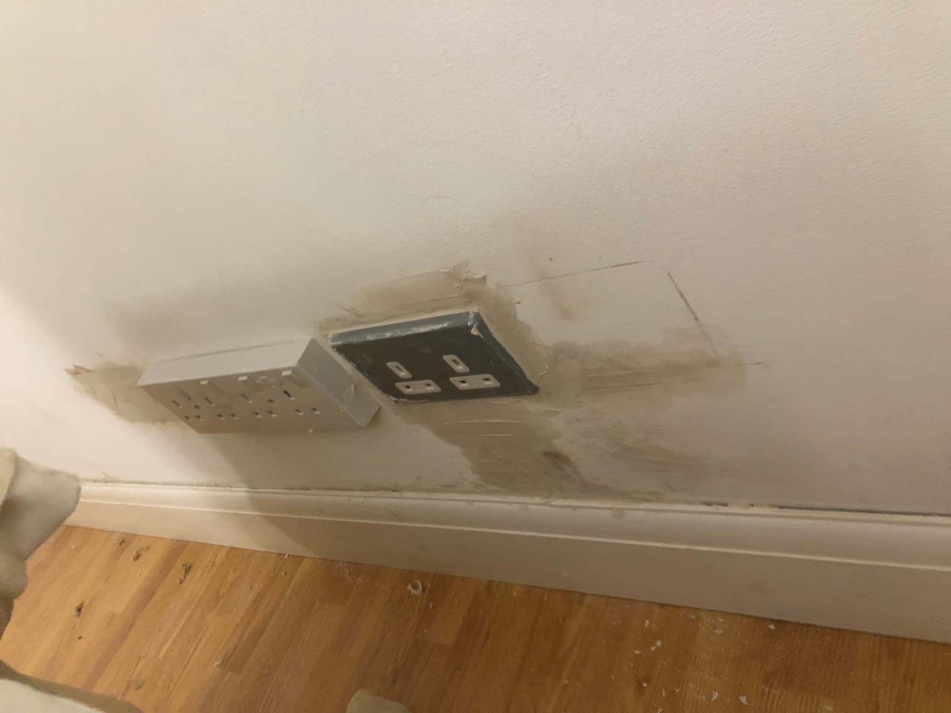

I did one run to this metal MK brand double wall socket for the main system - my two PS regenerators go into these
The PS then power the two Lyngdorf amps (one for the Quads, the other for the W210 bass speakers) plus the SOtM gear and network switch
The other white plastic box on is the general house mains - that is used for a couple of Hue lights and the diffuser backlights - this used to be used for all of it

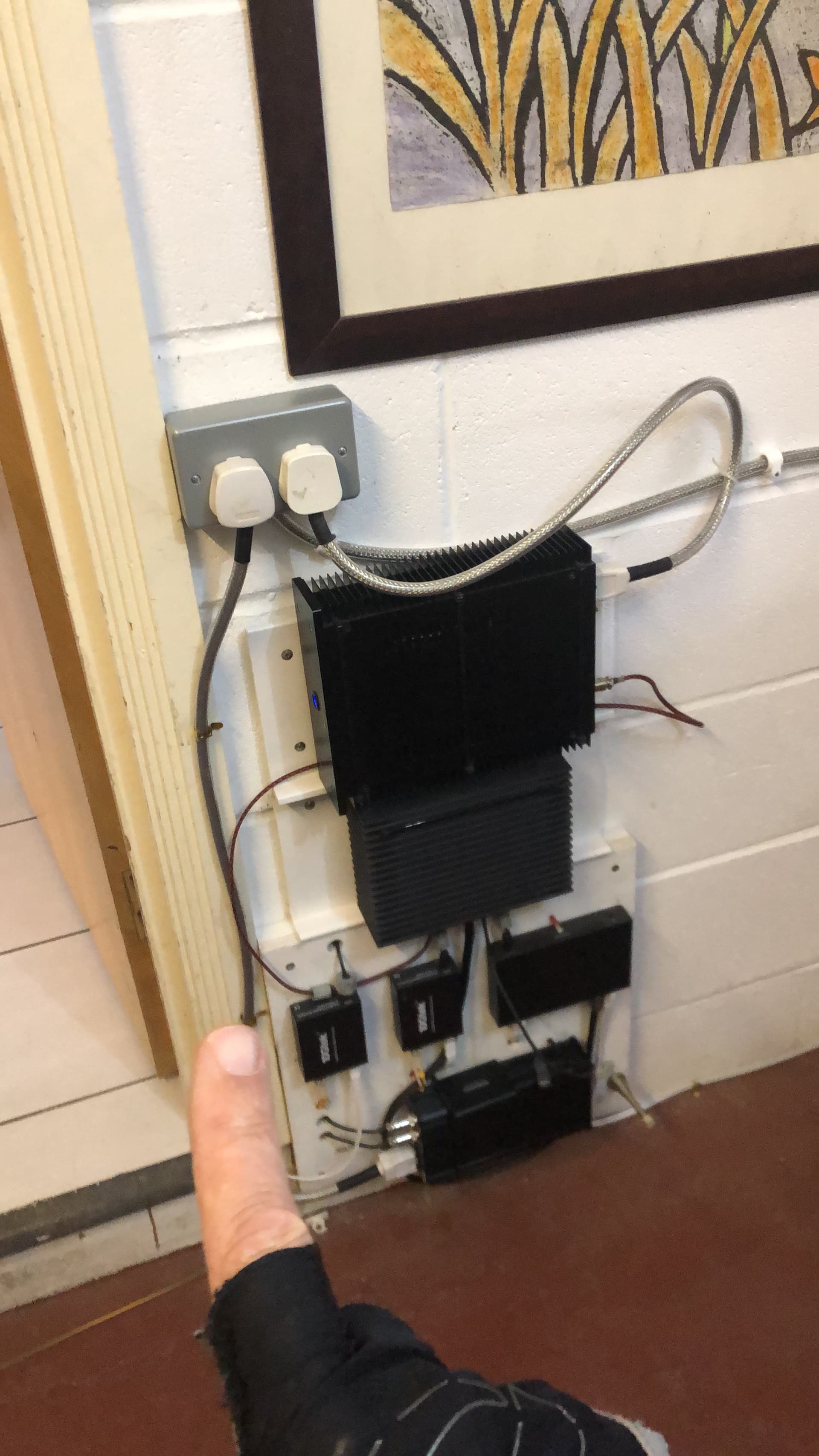

I ran another dedicated cable to my network section, again with a metal MK double. As it’s on the wall in the garage, I just surface mounted the cable and the box
That has two LPS plugged into it. One for my Nucleus, the other to power another network switch and a short fibre converter loop
