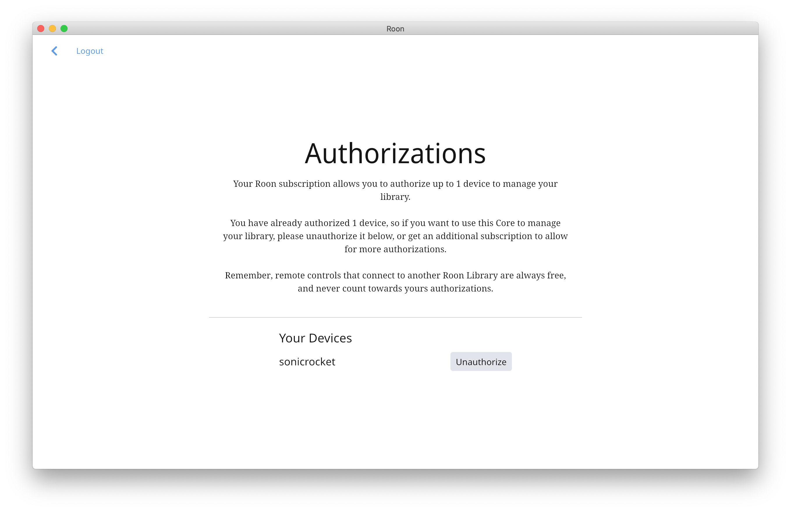

I had the same issue running Roon on QNAP. I have to login On my iPad what takes a Very long time. Then I was asked to deauthorize my QNAP Roon server. Very strange cause this is my only server for Roon. After I deauthorize my only roonserver everything was Back to normal again. Strange behaviour.

Hello nuwriy, my issue is already solved by deauthorize the roonserver on my QNAP nas. However, this was the first time I have to login after a new update from Roon. I use a IPad Pro as control. The login process takes a long time and I wasn’t sure I typed the correct password. But after a long while the deautorize message appeared and after I clicked on that everything is back to normal. Roon is working fine now.

I have been having this problem (asked to sign in and then deauthorize NAS) ever since updating to the new Roon version. I have the new Roon Server (2020-06-22) from the App Center on my QNAP TS-253A, and I’ve restarted Roon and rebooted the QNAP a couple of times. Each time it initially seems to work but then the next day (NOT restarting the NAS) I again have to log in and deauthorize the QNAP. This happens whether I’m using my iMac, iPad, or iPhone to control Roon. What else should I be doing?

I do have the same issue with my Synology NAS which I recently did set up. The setup-up was done as recommended.

After NAS restart I have to re-authorize Roon. To do so i have to choose the unauthorize option…

Hi Knud,
Yes, just click the unauthorize option and a new authorisation will be saved on the Synology core. Don’t worry, authorisations can’t be lost and you can reauthorise any device as often as you want. But only one device can be authorized. As the authorisation is not stored in the database, it is normal you need to press the deauthorize button.
I am guessing, you have openvswitch turned on. This is a known issue on Synology and fortunately it looks like this will be fixed with DSM7 (which will be available in summer according to my last google search). If you don’t need openvswitch and it is turned on, please try to disable it and restart Roon Server.
