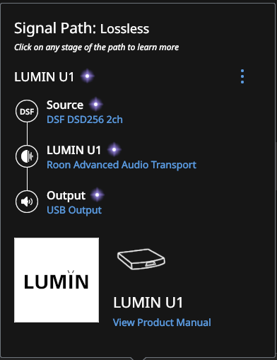

Dear Peter @wklie,
I have 2 questions:-
  1. when I play DSD256 files via ROON, the Lumin U1 doesn’t play any track it just skips the tracks. But if I Set DSP to convert the DSD to PCM, then it plays.
  2. When I play DSD128 the Lumin U1 Converts the DSD to 352.8KHz PCM, but plays instead of skipping the tracks.
    Is the conversion because of the volume control?
    Regards,
    Tushar.
Which DAC are you using?
Why are you set Lumin streaming to on?
