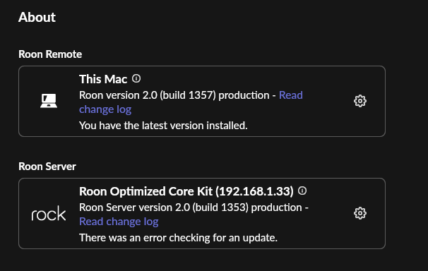

Can’t update to 1357 in the app or on the webpage, per below.
Everything else work fine - no issues
Can you provide assistance.
Screenshot 2024-01-05 at 13.37.34
Screenshot 2024-01-05 at 13.34.42

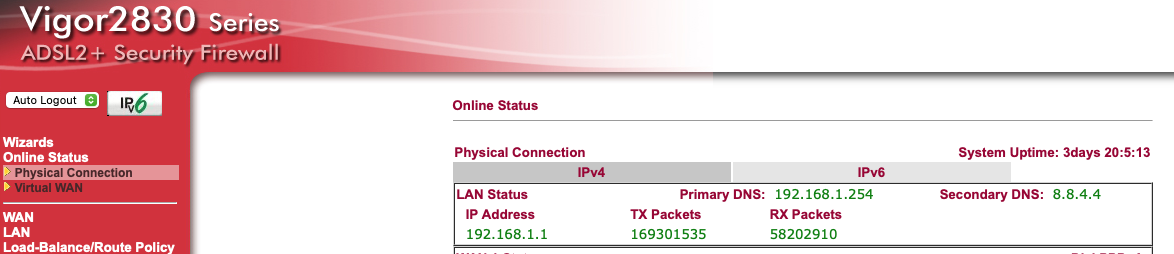

This is what the Draytek reports

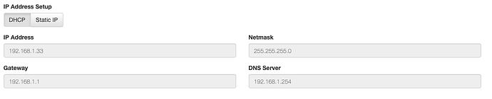

and this is what Rock reports

I think that looks OK, but I confess that I am unfamiliar with the Vigor2830 modem/router and its 400-page manual(!).

Thanks for your help but with the help of a friend we got it sorted. Changed the Rock settings to static and made the gateway the same as the IP address.
Downloaded and updated.
