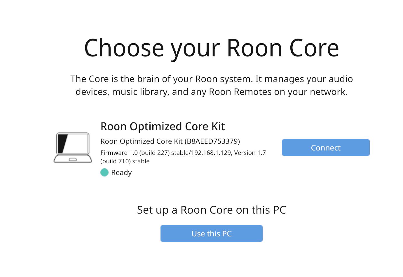

Hi Noris,
Unfortunately I couldn’t make it work,
02/08 07:13:12 Info: Starting RoonServer v1.7 (build 710) stable on linuxx64
02/08 07:13:13 Debug: [easyhttp] [1] POST to https://bits.roonlabs.net/1/q/roon.base. returned after 765 ms, status code: 200
02/08 07:13:13 Trace: [bits] updated bits, in 800ms
02/08 07:13:13 Trace: [brokerserver] Enabling broker server
02/08 07:13:13 Info: [broker/distributed] HTTP server listening on port 9100
02/08 07:13:13 Trace: [broker/backups] initializing
02/08 07:13:13 Trace: [broker/accounts] Data updated. AccountStatus=NoAccountConfigured MachineStatus=NeedsAccount UserId=
Does this mean my account information needs to be re-entered?
I connected two remotes from Windows and IPAD. Both are connected to Core on the IP level (log file)
But they show “Trying to connect” , so I have no possibility to enter my account details and other configurations.
02/08 07:13:38 Info: [brokerserver] Client connected: 192.168.1.192:49547
02/08 07:13:38 Trace: [SOOD] Adding User IP 192.168.1.192
