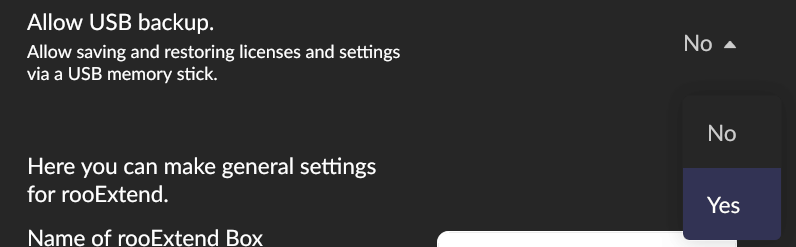

What about making a backup a USB-Memory stick and insert it in the second Pi before powering it on? As far as I remember the configuration is also saved on the USB stick.

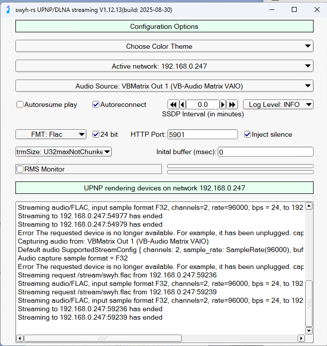

What I did is installing VB-Audio Matrix on my Roon Server plus a tool called swyh.rs. The latter is a Tool that grabs audio from a windows device and you can access it via http.
VB-Audio Matrix creates a lot of ASIO and Windows devices. You can for Example stream from Roon to a virtual ASIO device and grab the signal from one of the Virtual Windows outputs and connect it to swyh-rs.
After that you can stream the http FLAC stream with a Radio station and you have a loop.

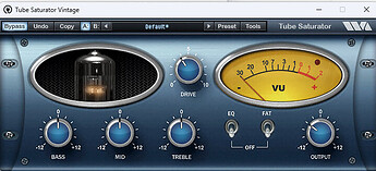

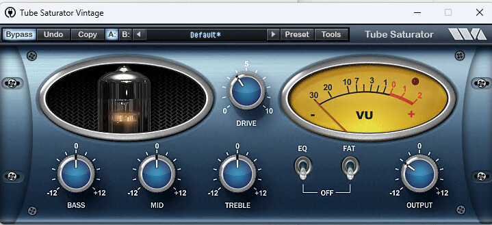

Next install a VST-Plugin on your server, insert it in the loop and you can apply any affect you like. I for example added the “Tube Saturator Vintage” in the loop.
