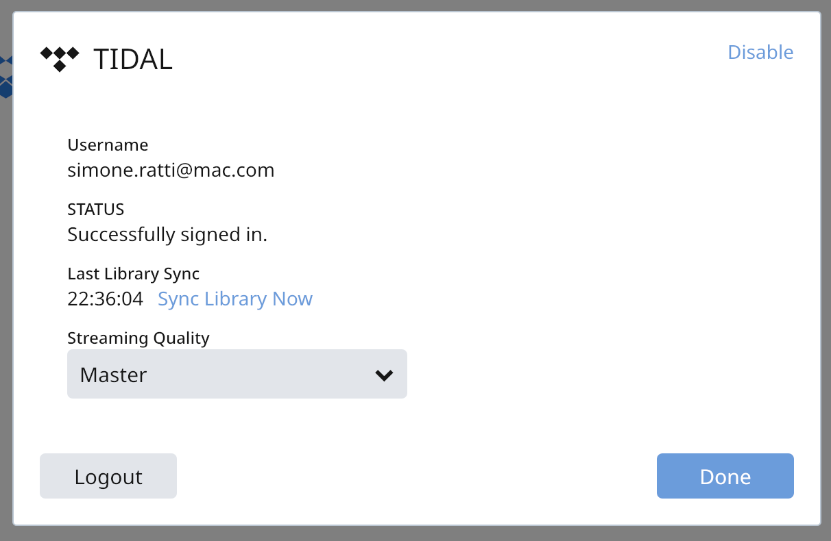

Roon does not sync correctly with Tidal favorites
Hello Noris, I have updated the BIOS to the latest and greatest from the Intel website and nothing has changed. I feel like blindly wandering around. Installing Ubuntu might be difficult for me, so I prefer not to do it. Wouldn’t be wiser to reinstall ROCK from scratch and see what happens?
Hello Noris, I have just finished reinstalling ROCK… I am sorry to say that I see no change! Still not syncing properly.

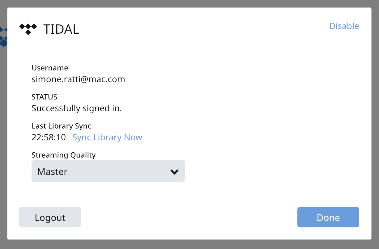

Ok, now the remote sees it. It is currently in the progress syncing but it is early to say if it behaves differently. I update you shortly if you remain online.
It seems to suffer from the same issue…endless syncing

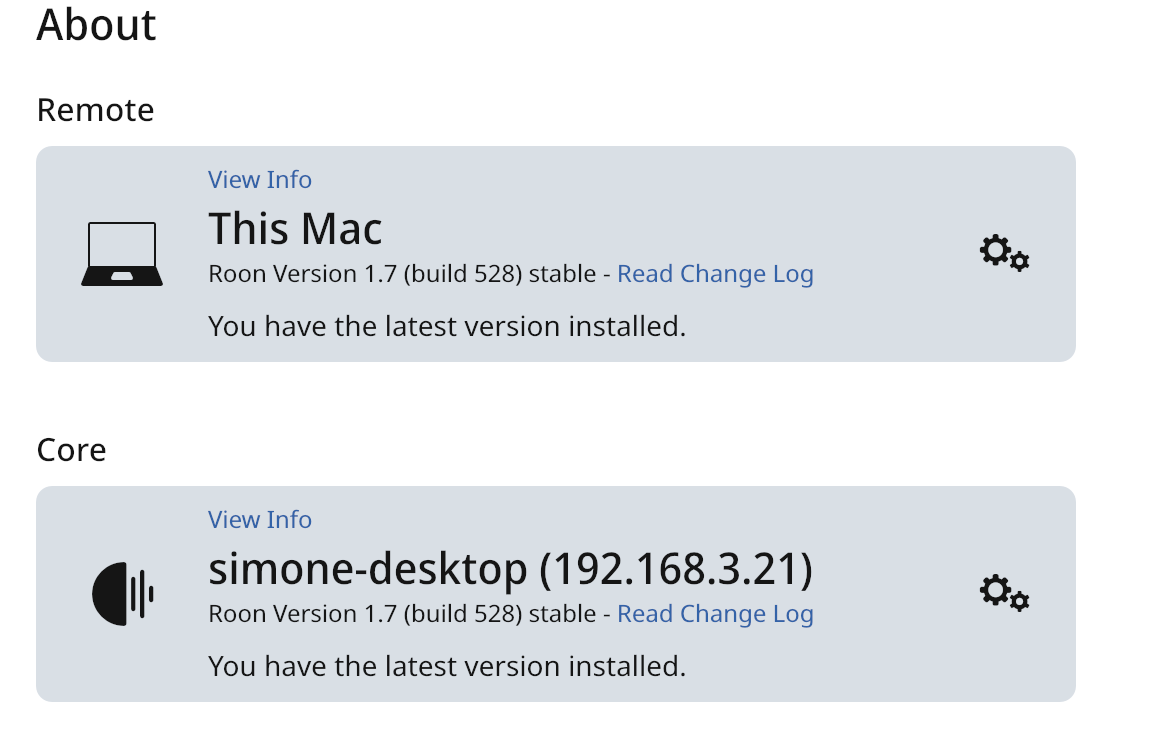

This is ubuntu running

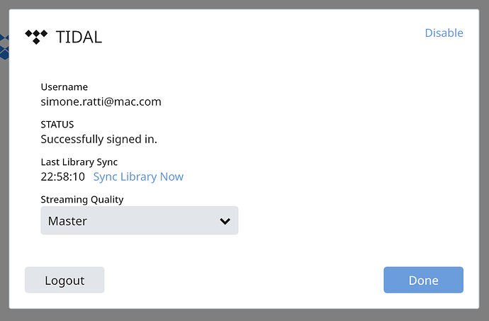

Look Noris, I have managed to setup on linux the wifi connection to a mobile AP and finally:
What’s wrong with my home network on linux based systems? On Mac Roon core it works great…but not on ROCK and Ubuntu. ROCK and Ubuntu work only out of my home network…working it around through a mobile AP.

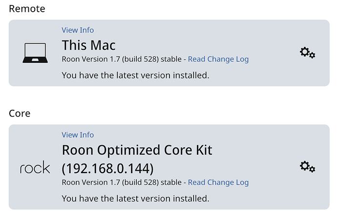

Confirmed…this is ROCK through the hotspot!

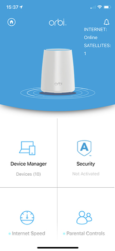

Not that I am aware of. Is there. A way to test? All firewall or security functions are disabled on the devices.
Difficult to know to be honest. On my system I have a separate app to manage the IPS and it effectively takes over from, and extends, the basic parental controls on the wifi mesh devices.
I see on the netgear site they talk about netgear armour coming to all Orbi devices via firmware update;
Are you aware of this being available/activated on your Orbi setup?
Thanks Tim…it should not be active as I see this popup each time I connect to the router inviting me to join
but I have never approved.
I have downloaded the app and checked on my smartphone to be sure
It says security Not Activated. I should be clean.
OK thats me out of ideas then really. I guess you could try actually enabling it just to see if that is the cause, and if so it then gives you the opportunity to fix it?
