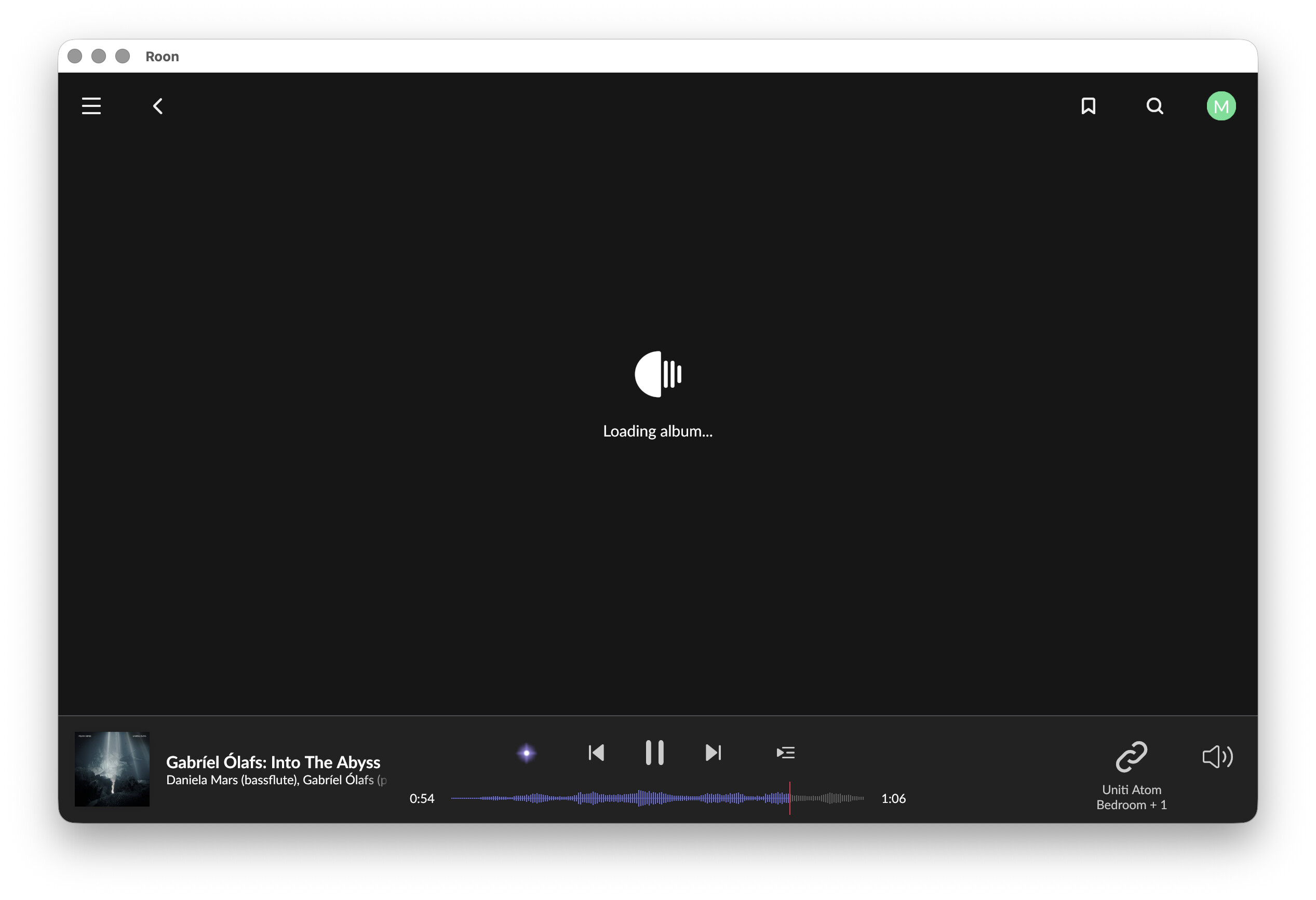

It always works after a re-boot. And I want to emphasize again I have never had a dropout. But when I click on an album page, the page freezes for 30-40 seconds before it appears… I have sent videos previously of this happening… anyway, have turned these things off… and will see what happens. As I am doing a reboot, I expect it will take 1-2 days to see a failure.

For your checking it happened at 8:36 AM MST. Loading the album Classical Meditation.

8:59:30 failed to load album. (Persian Hours). This is just going to continue until there is a fix of the server software.

1:44 PM MST.. first use of the day. First album loaded, no issues. Second album took 1:50 (!) to load. Vaughan Williams choral pieces. Really not acceptable.
Have tried experimenting over several days… any day I reboot the server everything works fine. On days when I don’t I get a hang. Today, for example, I loaded 3 Cds, but CD 4 called ‘Passio’ hung for 30 seconds and then finally loaded. I think we are beyond coincidence about the server being the issue.
