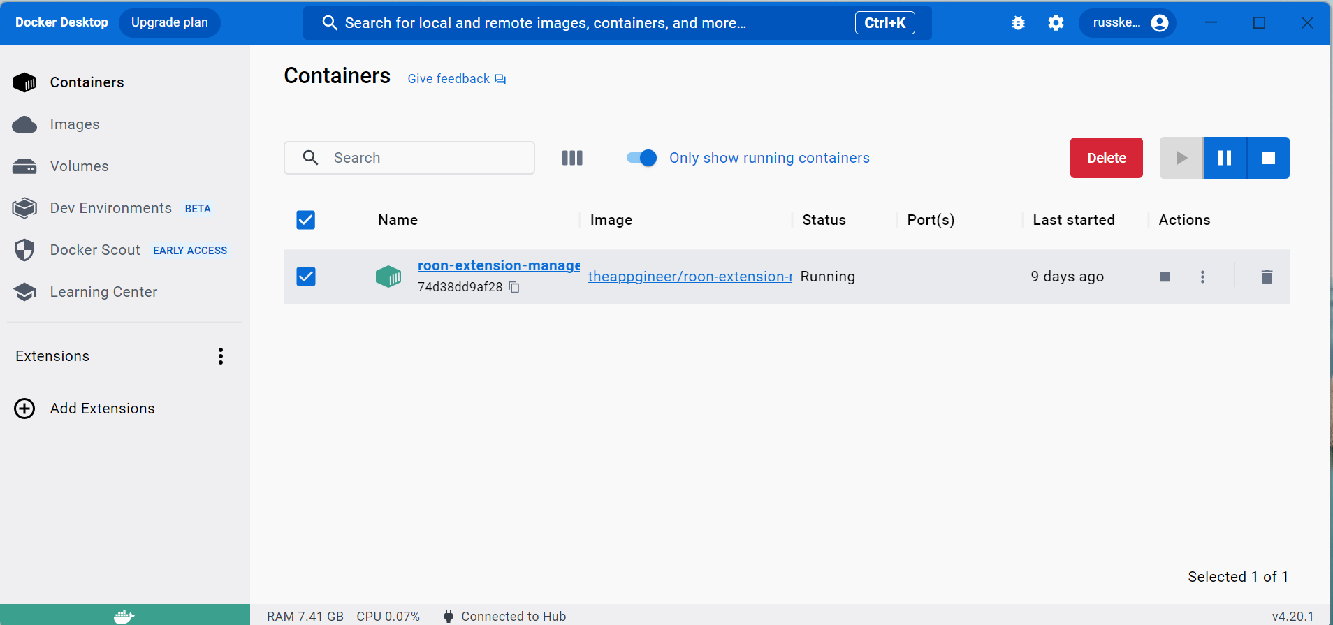

Hi Jan, thanks for all your work. I am new user and have moved to Roon and shutting down all my Sonos servers. But they did have a nice alarm which you have kindly built an extension for Rune. As instructed added LINUX and Docker to my Win 11 desktop where my Roon Core resides. And as instructed I downloaded the Roon Extension Manager container and I can see it in Docker.
Please forgive this really dumb question, but what do I do now so that I can see the Extension Manager in Roon and download your Alarm Extension? When I go to Settings/Extension in Roon there is nothing there. Again, sorry for the dumb question. Frankly, I was happy to get it this far!

Hi @Russell_Keziere,
Welcome to Roon and the Roon Community!
The problem with running Roon extensions in Docker and not seeing them appear in Settings/Extensions typically turns down to the use of a different vlan/subnet by the Docker installation. An extension can only discover the Roon Core if it is on the same subnet. As far as I know this cannot be achieved with Docker for Windows.
What does work on Windows is setting up DietPi in a Virtual Machine, instructions on how to do this can be found here.

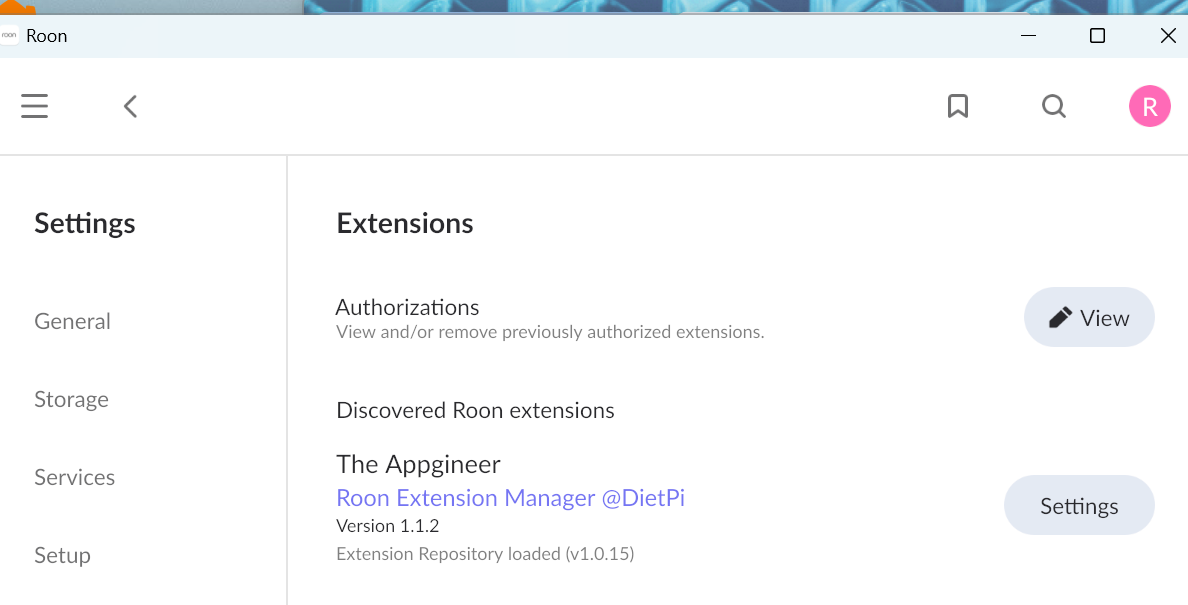

Having got that far, however, while I can see the Roon Extension Manager, when I click on it I get sent to website on machine do download a zipped log file with nothing in it. No listing of available Roon extensions. I am sure I am doing something wrong. But I am persistent. Thoughts?

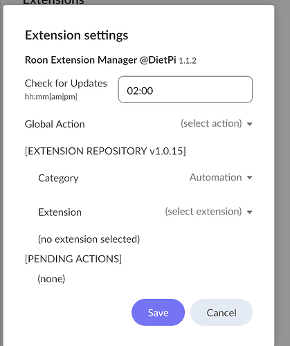

Have you clicked the settings tab?

It sounds like you clicked the hyperlink “Roon Extension Manager @DietPi” this will indeed open a webserver and download a file.
You should instead click the “Settings” button to the right.
You can the select a category of extension.
After doing so, select an extension.
And finally an action for the extension (eg install, start, stop, uninstall…)
Edit: so in you latest screenshot, pick an extension below the category. After doing so, you’ll see an additional field for the action
Well thank you Sven, Jan John! In retrospect, its intuitive. Alarm is now set and everyone is happy. Should have read Roon Extension: Alarm Clock v0.9.1 (current) much more closely, all spelled out there. Thanks again!
