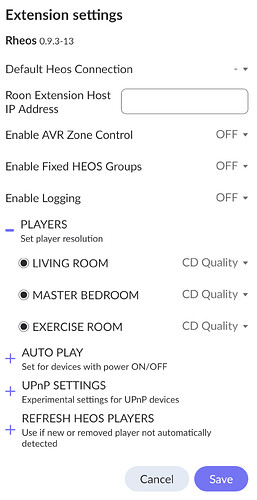

Stephen,
You are running on QNAP right?
  • rheos is not crashing?
  • you have stopped rheos, stopped roon, then restarted roon, wait, wait a bit more, then rheos
    ** i find this helps roon cache every once in a while - but is of limited use
  • in the extension authorizations, you only see rheos 1 time?
    ** it doesnt hurt to remove rheos, then re-add it in the extension area btw
  • in the top of rheos settings you do not have anything in the default-heos or roon ip addr field?
  • in the upnp settings at the bottom, rheos found the IP address to your roon server?
  • you see the players in the list (from your prev screen shot it looks so)
  • you Deleted the fixed groups listed there?
    ** delete and save, to close rheos settings then go back to settings
  • you turned OFF avr zones
  • you turned OFF fixed groups
now on to roon
  • in audio, do you see the 3 devices you have?
  • go to roon Setup and turn off squeezebox
  • go back to audio - do you see any ghost devices?
  • go back to Setup and turn on squeezebox (or click the button that says enable sbox in audio)
  • see if you can now see the audio devices…
lets pause here…

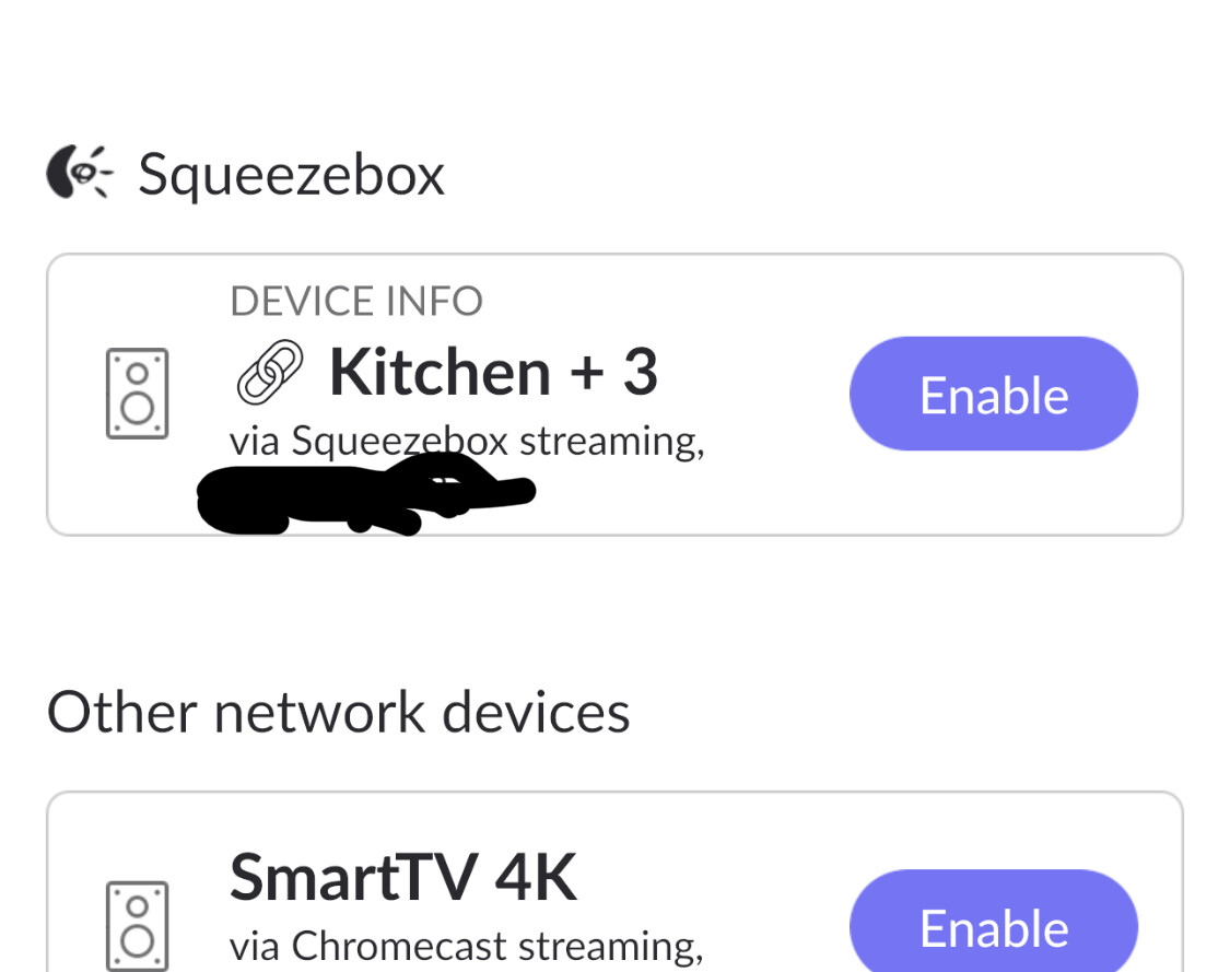

Here is what I get under Roon —> Audio
and in rheos settings, players you still see the list of your devices?
Yes.
can you change one to hi res and save and then restart rheos…
then go back and see if it stayed hi-res between restarts of the docker
Are you running the container with network:host
i think he is running qnap bridged - so it could be that multicast is now allowing roon to see your exposed sbox devices…

When I change it the Hi-res, it just shows it Saving. It doesn’t look like it actually does save. It just keeps going.
