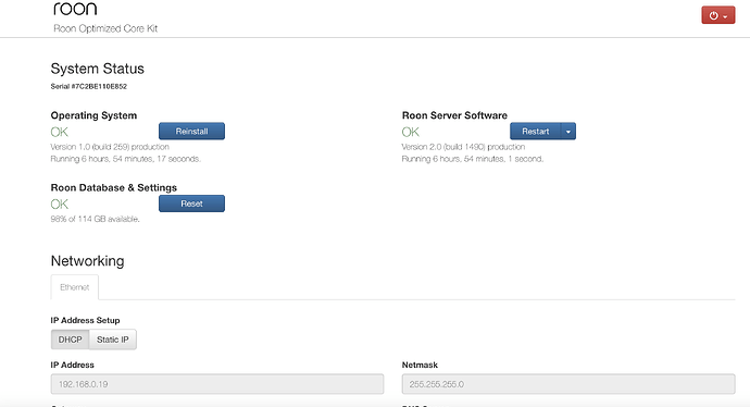

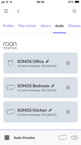

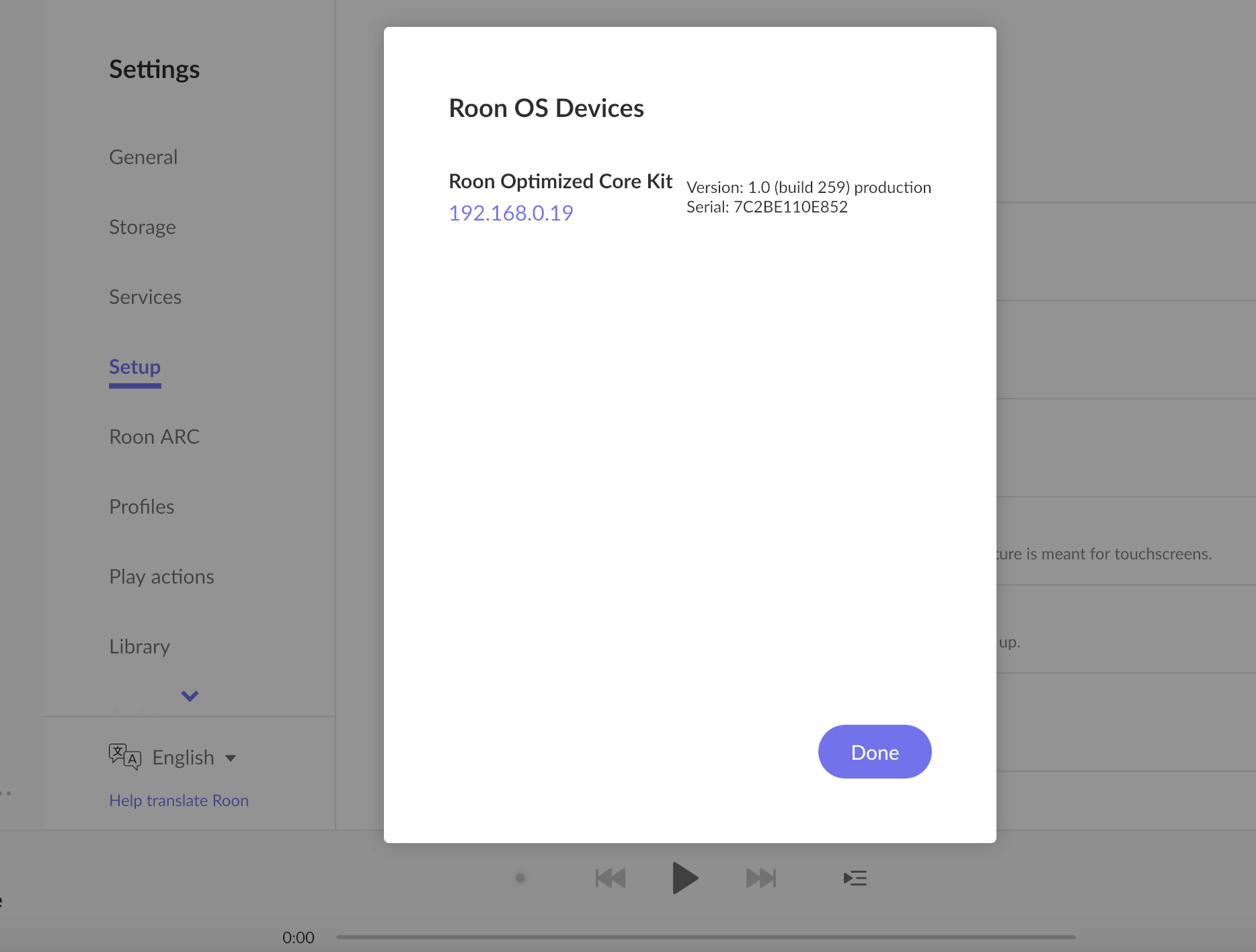

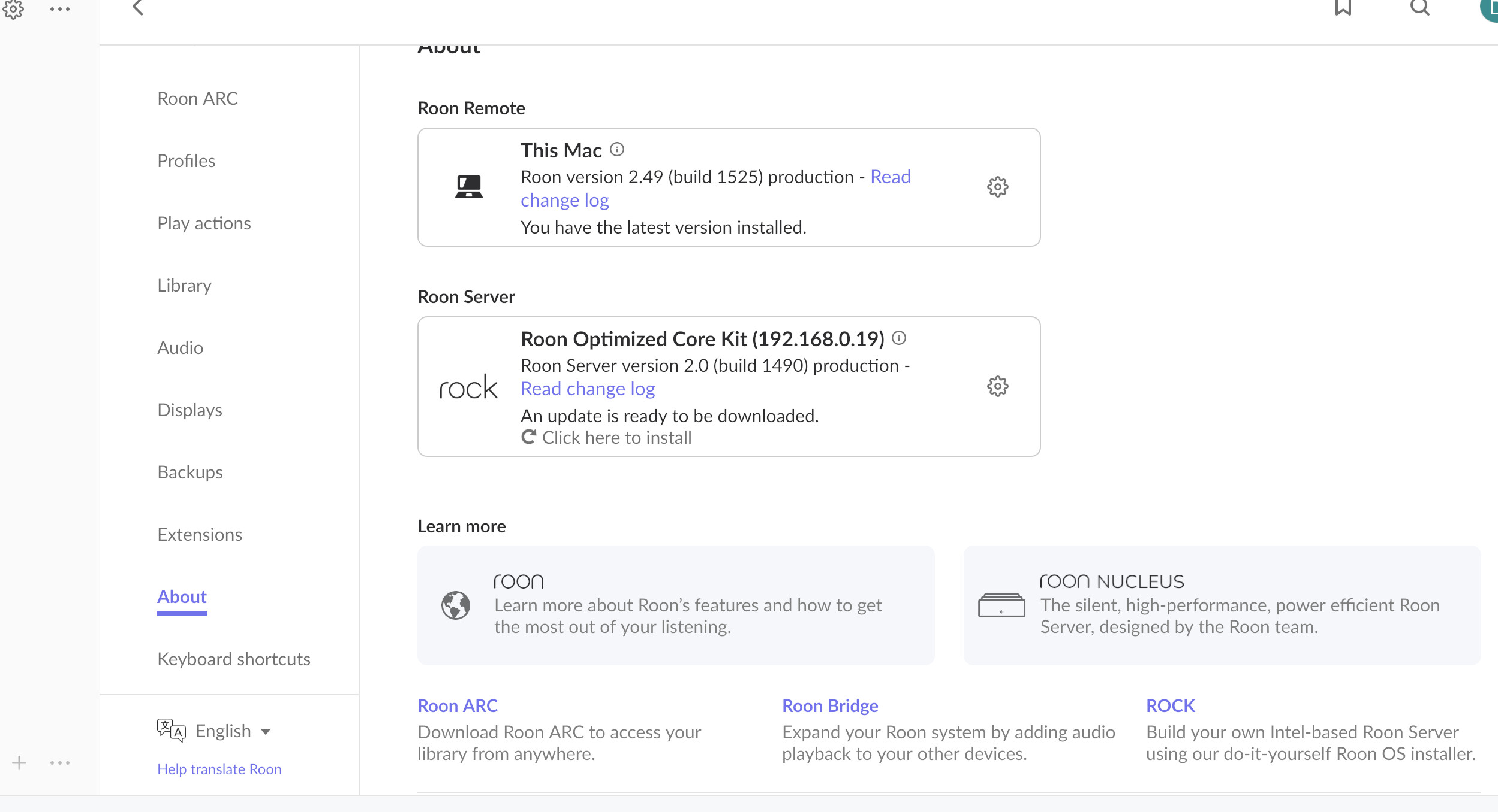

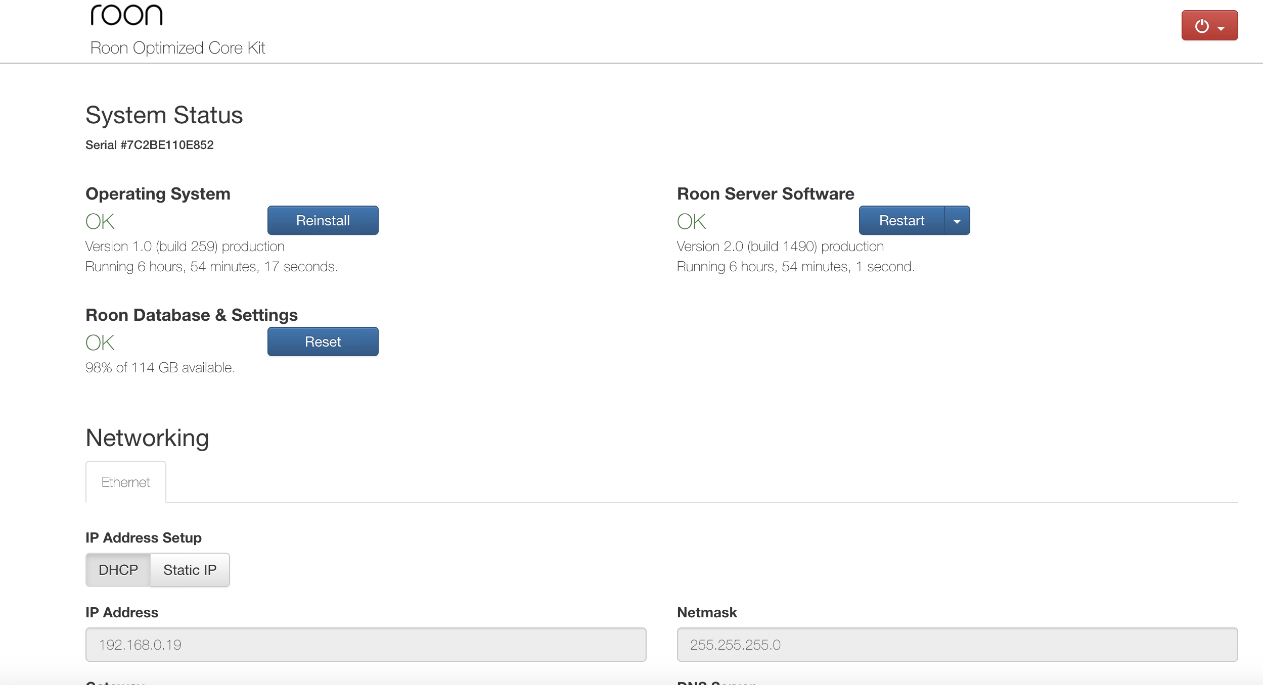

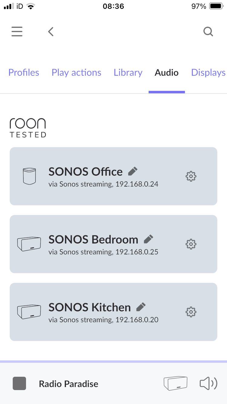

I am not an expert on this and so have added screenshots below of what my server is on and my end points
They look the same apart from the last digits
So this morning Roon cut out again , I had to reboot my router and the server and it defaulted back to the old firmware. I get this every time there is an update, days of firefighting and constant defaults back to the old firmware
They are definitely on the same network. The last number being different is because your router assigns a different address to each endpoint. It is like a row of mailboxes in a street. Each house has a different number, so each mailbox has a different number as well.
I have no idea what causes your Roon defaulting to its original firmware. My Rock doesn’t do that.
The devices all look like they are on the same subnet so that “should” not be an issue.

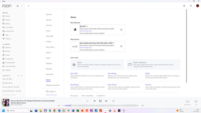

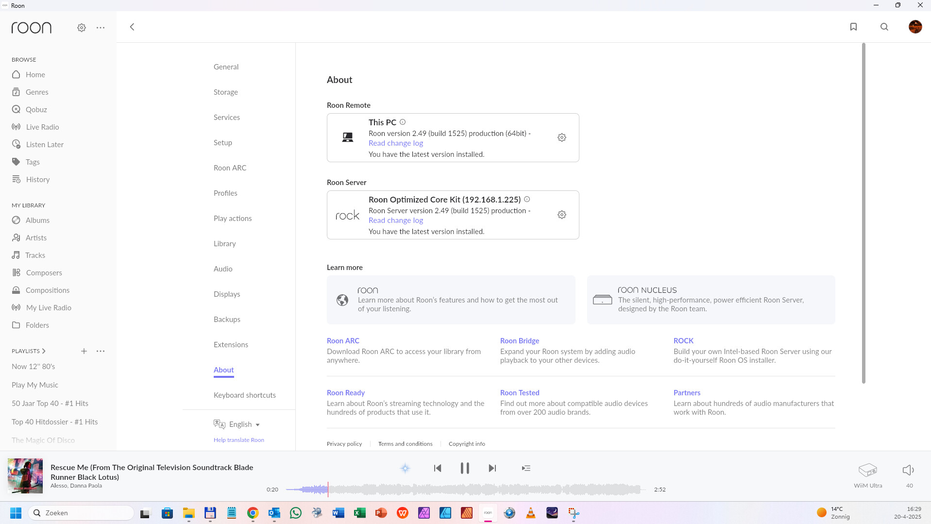

Take a look in settings/about and make sure all the devices are on the same version and build of Roon. Can you post a screenshot of settings about and the webUI for ROCK?
An issue I see is that you appear to be on an old version of ROCK (version 1.0 build 259).

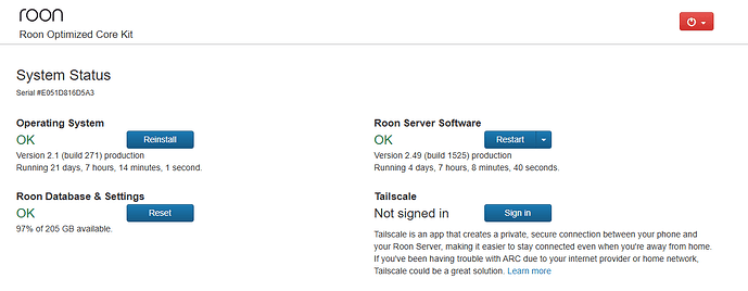

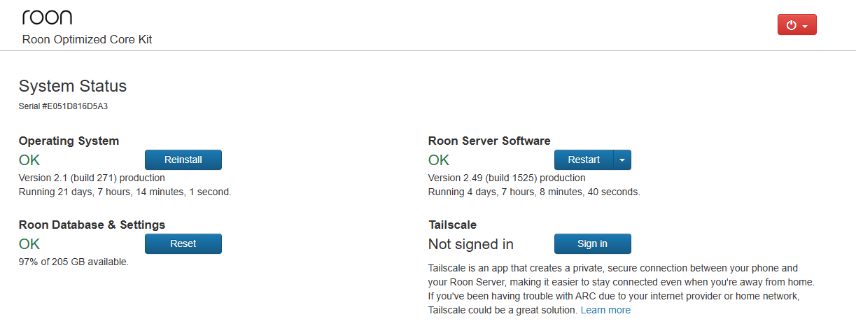

The latest ROCK is at least Version 2.1 (271) as far as I can tell from the software release section of the forum (I am on early access so a different version of ROCK) look here:
Also, Roon OS is version 2.49 build 1525
You may need to re-install ROCK to get to the latest version, I would also suggest making sure you are using UEFI in the BIOS in your NUC in order to get the latest features (tailscale and other features).
The above items “might” be what is causing some of the problems you are seeing.

Yes you are correct I am on an old version as per attachment
How do I upgrade it? I dont have a spare screen to plug the server into so have to do it remotely, I guess I can just press the reinstall right?
This is the current version of ROCk on my little NUC. I’ve bought the machine just over a month ago and I installed from fresh. With an USB stick with a ROCK image from here.
I’ve connected the NUC to my TV in the living room (HDMI) and used a spare USB keyboard during the installation. After setting it all up I’ve disconnected all the cables (apart from power, network and the external HD which holds my music). And since then I have only accessed the server through my web browser.
Updating to Roon OS 2.1 Looks like you’ll have to start from scratch to get to 2.x.

I take it that when you click the “click here to install” you are seeing on the about page is when you are getting the loop and issues? correct?
It would not hurt anything to try the “reinstall” option on the webui. It “might” fix your issue?
If your issue continues I woul ssubmit a support request from the support section and let the Roon techs review your logs.
On another note: when weird things like this start happening it may be best to start from scratch after the final option above is tried. You just need a TV or monitor and a keyboard for the install process.
And yes, it is not entirely necessary to update to 2.1, but if you are going to need to re-install anyway… there are more features than Tailscale that you will not get if you stay on an older revision.
