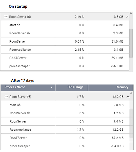

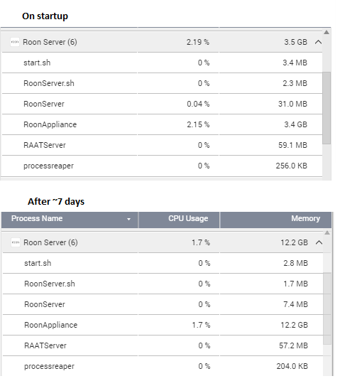

Roon is leaking memory on my QNAP again. I think I’ve seen reports of this before - indeed I think I’ve experienced this before - but not for a while.
On startup Roon grabs about 3GB memory. 7 days later this has grown to 12GB and performance gets very sluggish. I restart the process and it drops to 3GB again - cycle repeats.

We would expect that Roon would use this amount of memory. I am currently running a test database on this Mac Mini and Roon is taking just over 1 GB with a 300-track (test tracks) library. I looked up your QNAP and found that it can have nice specs with 32 GB of RAM and a Core i5 but it can also have lower Core i3 setups. Can you clarify what the specs are? Is it dedicated to Roon or also performing other functions? Is the core wired?
Sorry for all the questions but we want to be sure of your setup. There shouldn’t be any sluggishness, especially with a library of that size.

Hi Wes. I have the i5-12400 version of this NAS with 64GB so it’s fairly well specced. It’s not dedicated to Roon but it’s not regularly doing anything else that’s particularly heavy.
My concern was that Roon would trundle along using ~3GB for a number of days, then very quickly jump to around ~12GB and start responding very slowly. A restart would drop it down to ~3GB and then the process would start again. That’s the characteristics of a memory leak.
