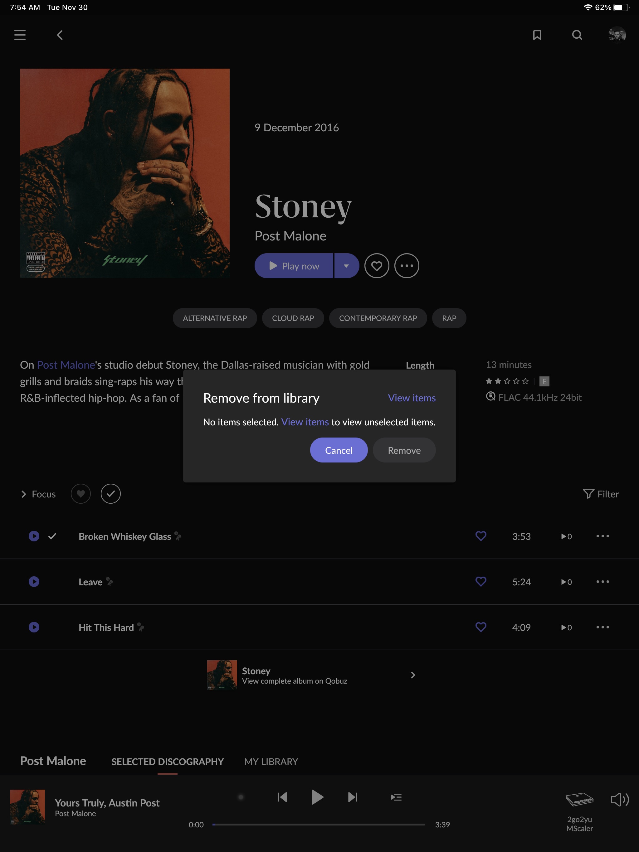

Hard wired since yesterday. AND surprise, surprise. ALL issues still appear.
Also if you read my initial post, how should it be a network problem if albums disappear from your library. or how does a network issue makes sense that I can’t delete an album from my library sometimes, or Qobuz albums show wrong album cover art?
