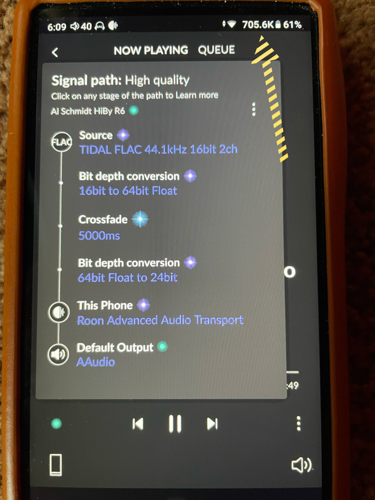

Some news about Roon Hiby new R6 downsampling? Thanks
Is it possible that the latest Roon update (Build 806) solved the android downsampling issue in our HiBy players?
Looks to me like it did! Yeah!!
No 44.1 has always played at 44.1 /16 or 44.1/24 on my R5 it’s only anything above 44.1/24 tgets down converted to 44.1/24 Roon sees the DACs limits as 44.1/24. That’s a bug I find happens sometimes and the rate gets stuck. Same as it was for my R5 hit anything above it’s downsampling.
