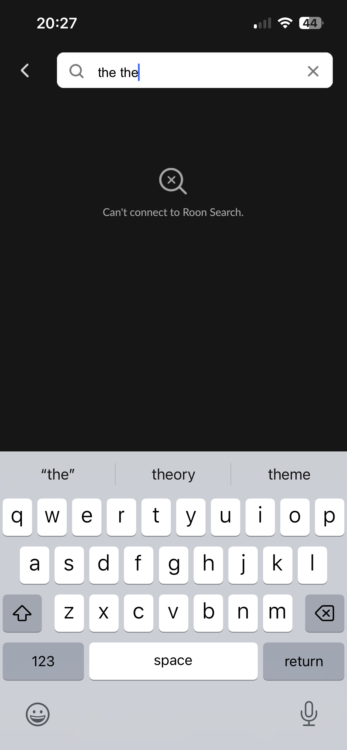

I disabled Qobuz and did a search for The The and it took about a minute to bring back this screen.
In general, search is no better with streaming disabled. Some saying can’t connect. Any using The in beginning takes at least 15 seconds. No instant results.

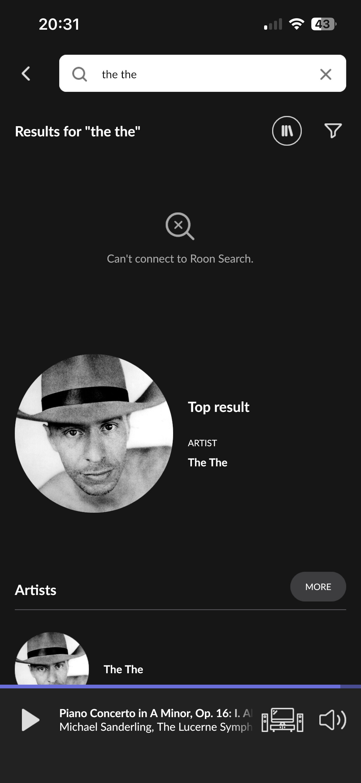

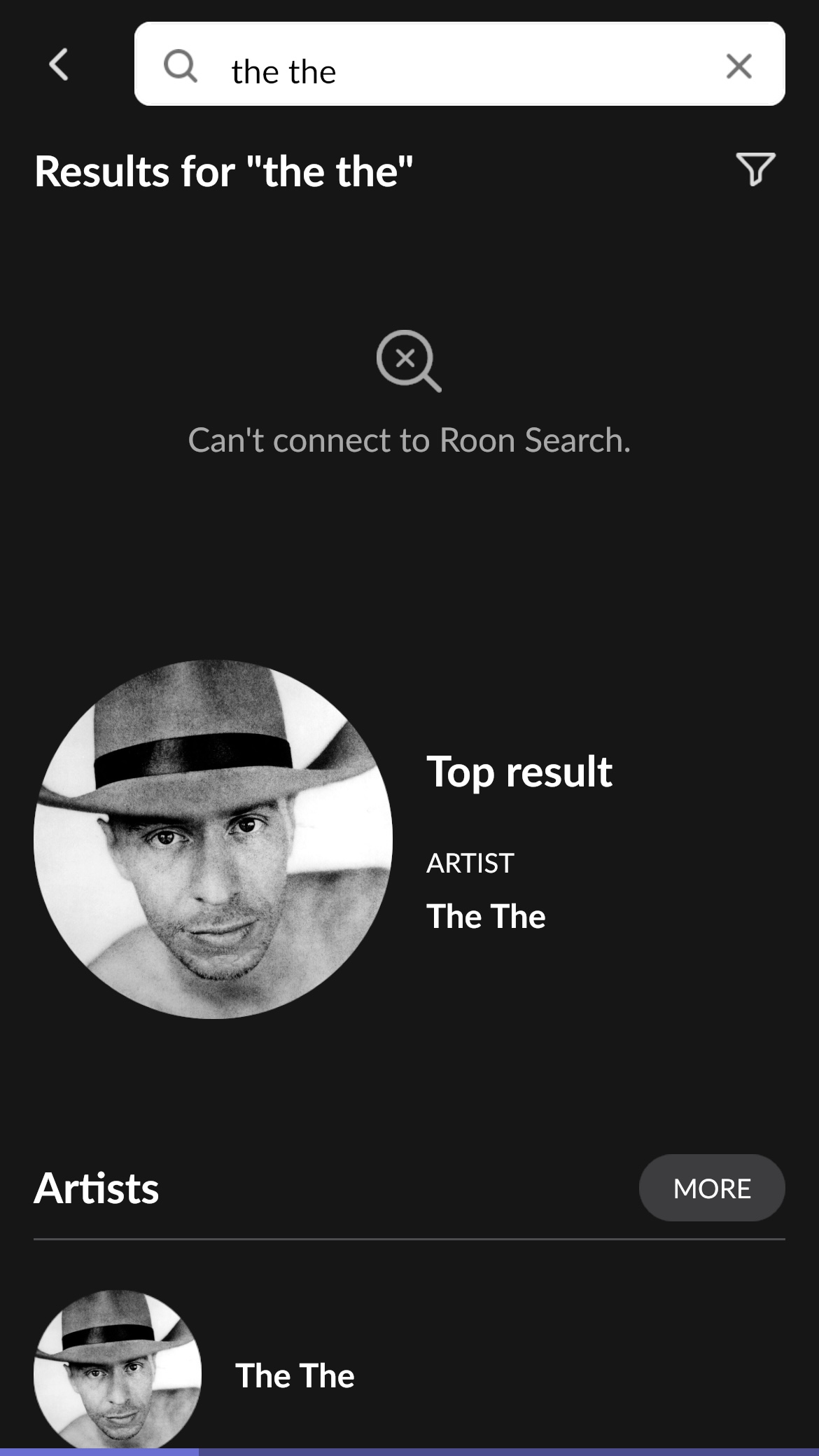

Disabled Qobuz and get no error but took a longer time than I would expect given they are in my library.
Enabled Qobuz and still slow then finally retuned but with error.
