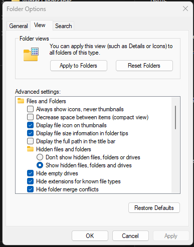

The Roon apps are usually to be found in C:\Users\<yourusername>\AppData\Local\ - look for the Roon and RoonServer folders there.
Note that the AppData folder is hidden by default - you need to enable the “Show hidden files and folders” option of Windows File Explorer to display it.

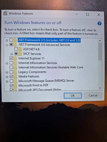

With that, can you confirm you have .NET Framework 3.5 is installed? If not, I would install it and then perform a fresh install of Roon Server afterwards, and see if you run into the same issue.

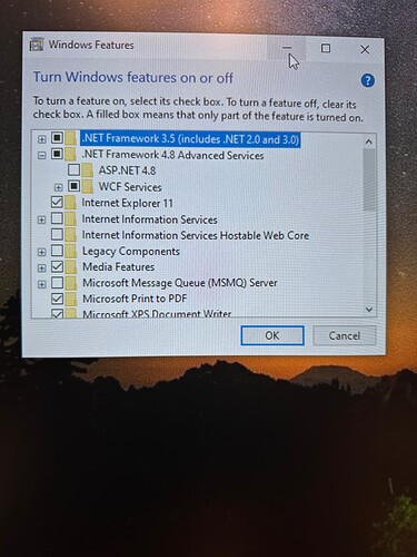

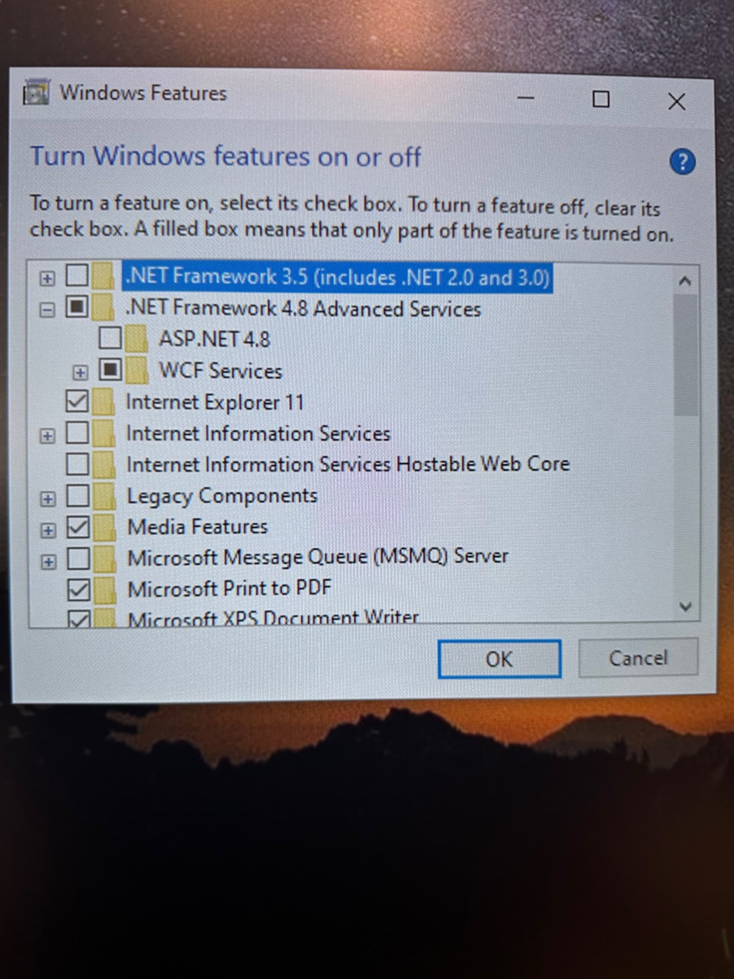

Here is screenshot of Windows Features on computer. It looks identical to the one you sent. We don’t have another computer to install Roon onto.

In the screenshot, .NET 3.5 is turned off. Can you please turn this on, restart your computer and attempt to launch Roon Server?
