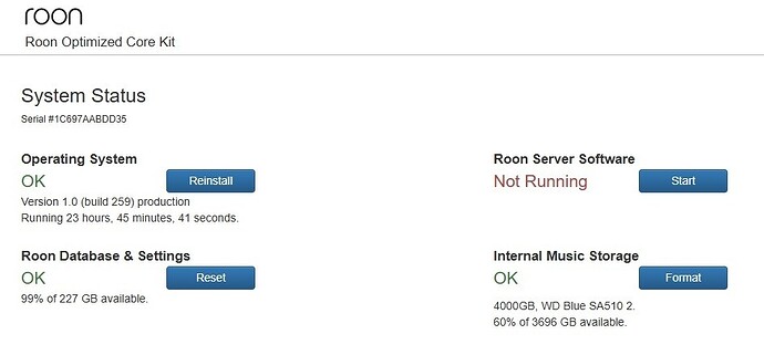

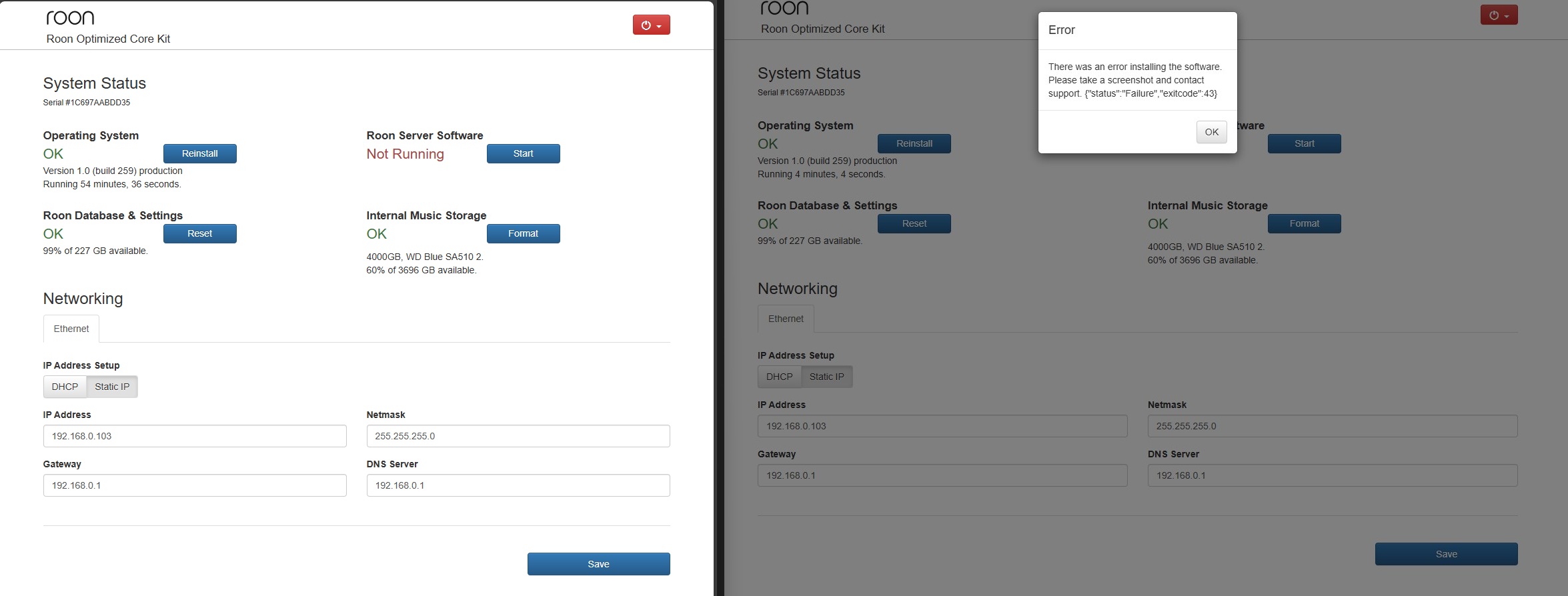

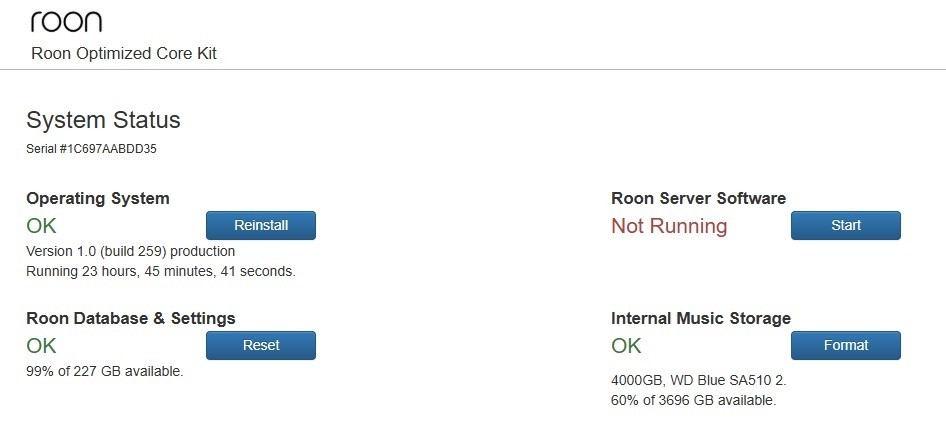

I was listening to the music and suddenly stopped, checking I found out that the "Roon Server Software" is "Not Running", I tried to start several times but was unsuccessful, I have tried to Reinstall to Operating System as well, but I got the error "exitcode 43"
INTEL NUC model: NUC10FLN
Serial #1C697AABDD35
Operating System: OK
Version 1.0 (build 259) production
Roon Database & Settings: OK
99% of 227 GB available.
Roon Server Software:
Not Running
Internal Music Storage: OK
4000GB, WD Blue SA510 2.
60% of 3696 GB available.
Conected through a Orbi RBR50 mesh, by lan cable and static IP

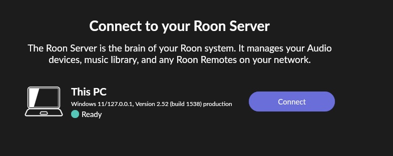

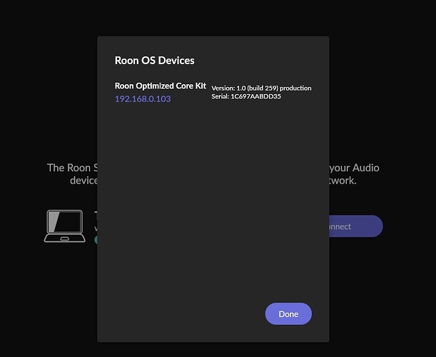

Sure, I am doing something wrong. The Roon Server is “Not Running”. I think the problem has started there, since the issue started, I could not start the Server…saying that, even with the Server not running, I cannot rename the “Roon Server” file, because it said it is in use…

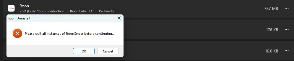

Ofer to connect to a “Roon Server” in the PC…not in the NUC…then I tried to uninstall Roon App in the PC but could not… is asking “Please quit all instance of Roon Server before continuing…” I have restated the PC, with the NUC off, and the same… again, sure I am missing something…
Hi @Omar_Martinez,
Roon Server may have been set to start on start up so that as soon as you turn on the PC Roon Server starts as well. This is easy to fix on Windows fortunately. With Roon running on your PC click on the up arrow in the taskbar in the right corner of the screen.
Right click on the Roon icon and you will see an option that says “Launch on startup”. Make sure that option is unchecked. You can also quit Roon Server from that same menu which would also allow you to uninstall it. Let us know how this goes and if you need any further help!

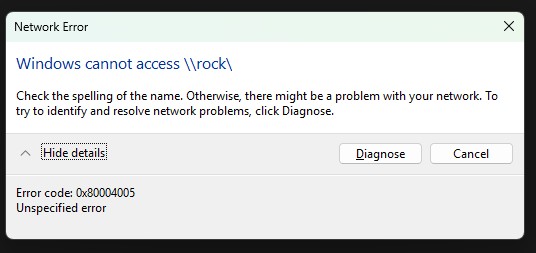

What happens when you enter \\rock\ in the Address field (not the Search field) of Windows File Explorer?
Hi Geoff,
I am attaching the screenshot of the error I am getting
Thanks for the suppor!

Did you try typing in \\rock\ in the Address field (not the Search field) of Windows File Explorer as I suggested earlier? What happens when you do this? Please post any error messages that you get. Thank you.
