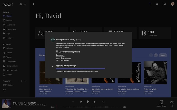

Still at it 32 minutes later:

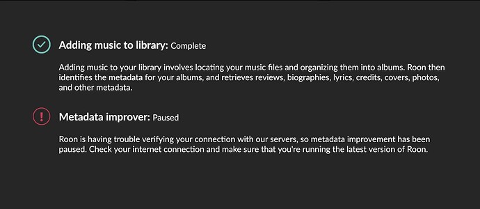

Here is the latest from Saturday afternoon. This is with the Roon server on ROCK. Note the "Metadata Improver: Paused” comment:
My internet connection is solid, BTW.

Following your guidance, I removed the Roon Album Tags from Yate, but still retained the Work and Part Fields:
I then went into Roon and manually removed those box sets with the unintended tags (in red boxes) and then ran a Force Rescan:
I think that cleaned things up. I now have only the few tags that I want to retain:
Can you run another diagnostic report to see if things are running close to normal?
