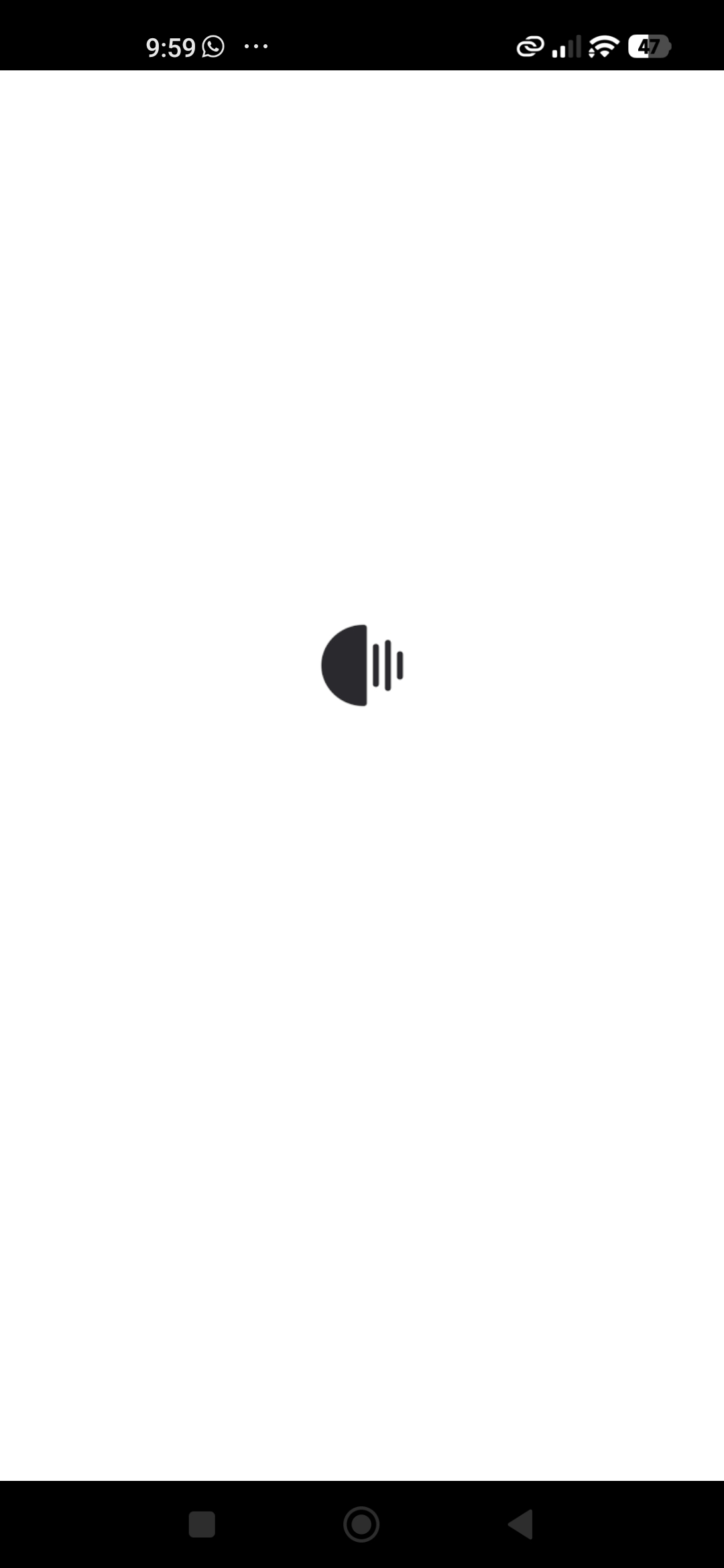

When you try to connect, what screen do you see? · Just the Roon logo

Describe the issue Players not found
Describe your network setup Nas Server on Synology DSM 7.3
