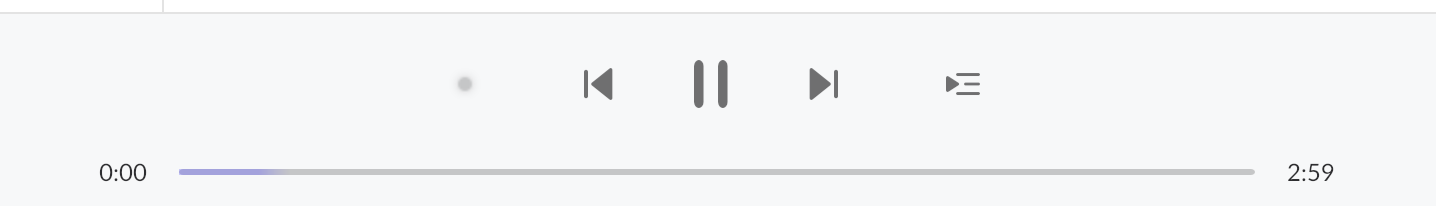

· OK for a couple of weeks now I can select an Album or playlist and Strat playing it. Then after a few tracks or sometimes more it just stops playing at the start of a new track and when you look at the 'Progess Bar' at the bottom of the screen there is a blueish line that just keeps going from 0.00 seconds played up to the end and then back again. I then have to click on another track to get it going again.
· I a using a Volume Rivo streamer and from there into a Denafrips Pontus DAC.
@David_Coombes - it’s a known issue with Qobuz - I’ve moved your post to the tracking thread.

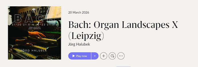

The fugue of BWV 542 does not play, the other ones seem ok. It does play on Qobuz (Chrome web app). Same on Lyrion Media Server.
