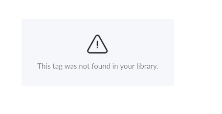

However, when I click on the tag link I get the following
I cannot find the beatport single tag anywhere else. when I go into the tag section or search under focus it is nowhere to be found. It doesn’t make sense.
