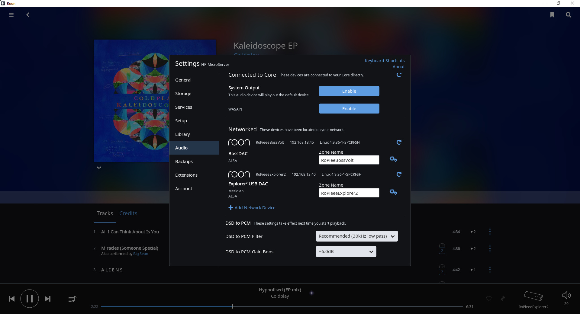

The RoPieee is not detected by Roon.

Display shows: “Connection Failure”.
RoPieee is detected by Roon.
I can play local music and Tidal music.

I sent feedback playing Coldplay - Kaleidoscope EP - Tidal Masters.

Have you approved the extension in the settings for roon core. You need to do this before it will work and then in the web interface you need to set the name of the endpoint you want to control.
Bingo !!! ![]()
Thanks Simon.
btw Nice job Harry !!!

Also, unsure whether this is a problem or not, but my unit doesn’t show up as an endpoint in Roon (with USB selected but with no HAT selected). This doesn’t matter in my case (I’ve separated the monitor and digi functions), but wondered if this is as designed. Running 4.9.36-1-SPCKFSH.
If there is a hat it will show up, likewise if there is a USB DAC connected and powered up if it’s a big one it should also show up, and if you have more than one USB DAC they too should show up assuming you have added them in the audio settings of roon.
