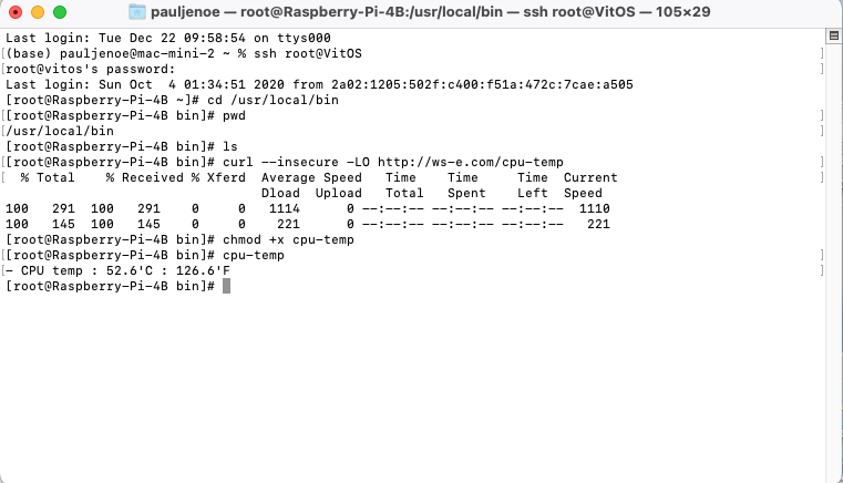

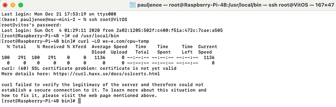

Hello @David_Snyder!
Thanks for your scripts. I tried them out. At least I am able to ssh the Raspi running VitOS.
But when I run the command (curl -LO [ws-e.com/cpu-temp]) it fails to download the script from the site and throws an error
curl: (60) SSL certificate problem
Please see attached file.
Could you help, please?
Hi Paul I took a look and it looks like the file has been moved.
Try using this command
curl --insecure -LO http://ws-e.com/cpu-temp
Remember to do the chmod +x cpu-temp

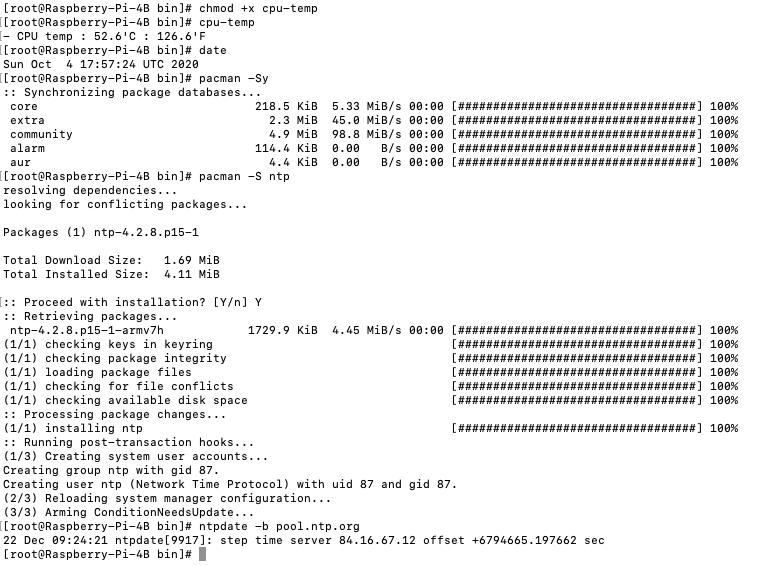

Ah, you can run into that problem with SSL if the date is wrong on your Raspberry Pi. You can set the date manually with something like this:
# date 122120082020.01
Mon Dec 21 20:08:01 UTC 2020
…where the format for providing the time is: MMDDhhmmCCYY.ss
A more precise way to do this would be to use NTP. You can do that by running these commands:
# pacman -Sy
# pacman -S ntp
# ntpdate -b pool.ntp.org
21 Dec 20:20:36 ntpdate[506]: step time server 66.220.9.122 offset +6833159.119951 sec
Once you’ve got the clock set properly on your VitOS RPi4, the curl command I gave will work just fine.

This works too…and I suppose is a bit easier than fixing the date. Thanks. :slight_smile:
@David_Snyder I have been bitten by this raspberry pi time issue many times before, but I actually forgot it this time when answering Paul’s request :wink:
Both options would work for Paul but your answer is better TBF

Worked like a charm, Mike! Thanks!!!
Checked the date on my Raspi 4, Mike, and as you suspected, it was wrong. Ran your commands and, voilà, the date now is corrected!

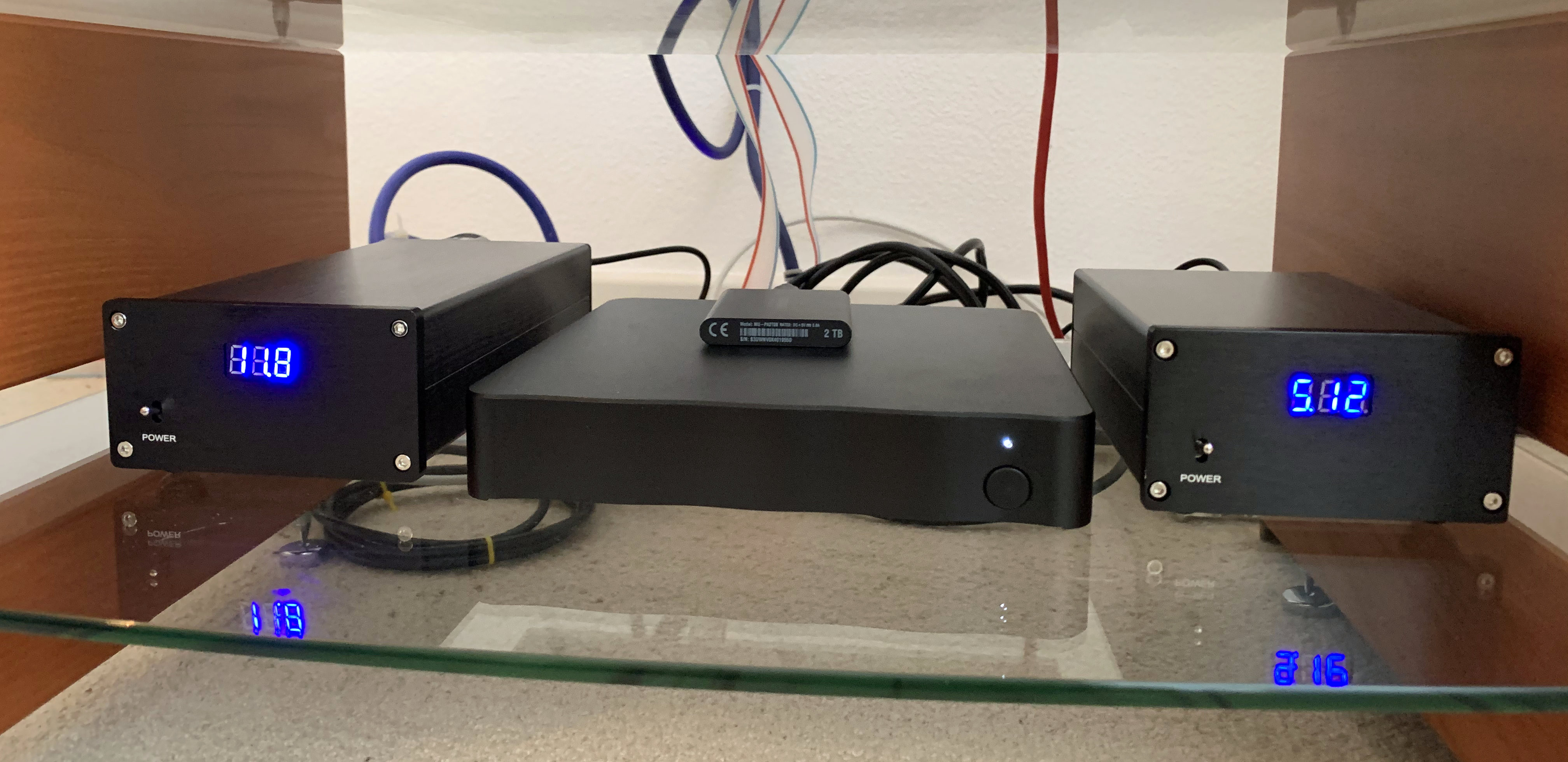

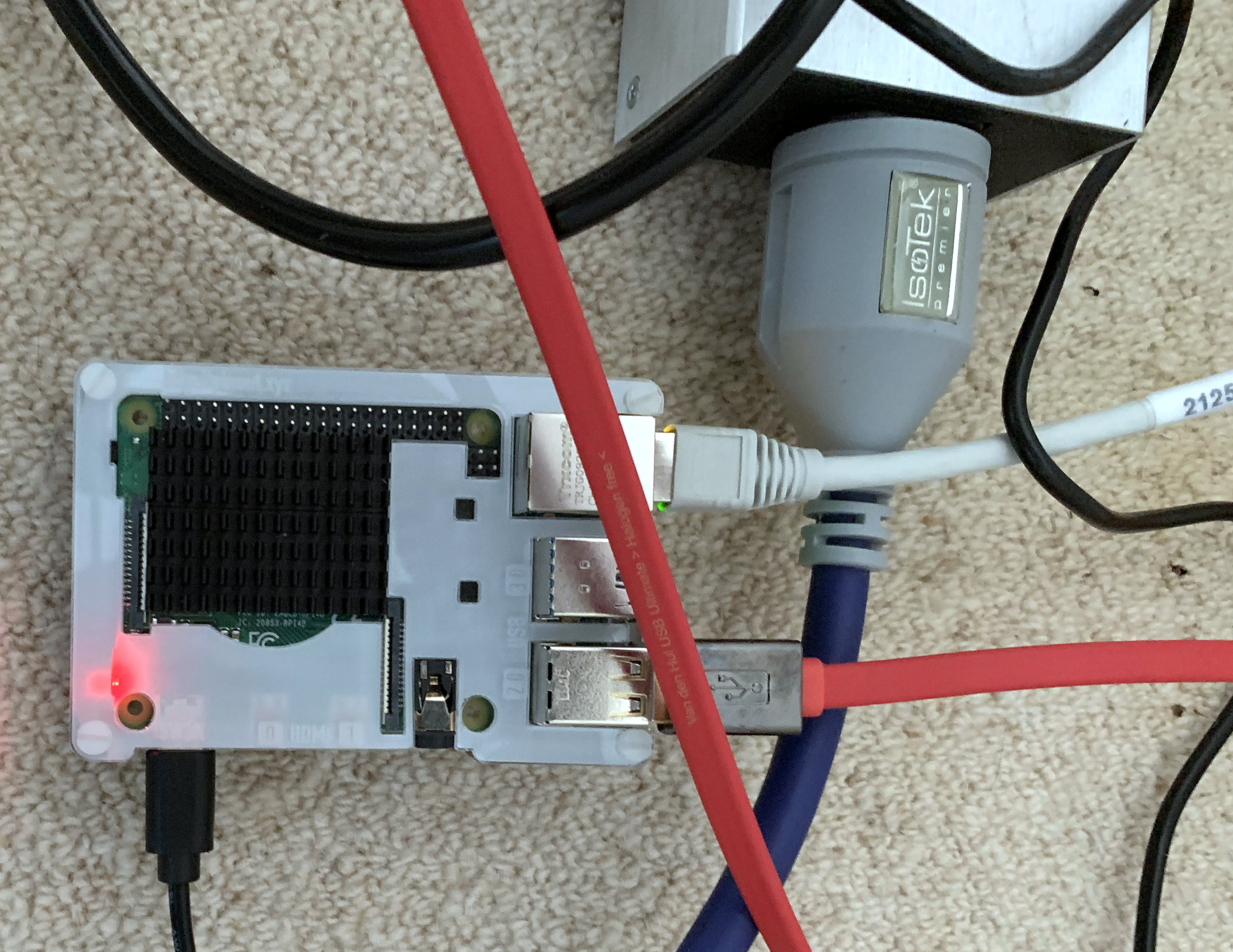

Here two pictures of the linear power supplies and the Raspi. The LPS to the left, displaying 11.8 V, feeds the SonicTransporter i5 (with a 2 TB SSD), while the right one (5.12 V) feeds the Raspberry Pi 4. Of course, an adapter is required for the USB-C power supply socket. The Raspi is tucked away somewhat carelessly in the maze of the cables at the rear of the HiFi rack. I should get a decent casing, like the Flirc. I’ll order one after Xmas.
Paul thanks for the photos, the Flirc cases are good, I have two for my headphone Pi’s, just remember to use the heat sinks as they can get warm running, though the Flirc has one for the processor.

For the heatsinks: I already have a heatsink mounted on the CPU. Do you say the Raspi fits into a Flirc even with the heatsink mounted onto the CPU? As far as I know, the Flirc case has some sort of a heatsink attached to the lid that touches the CPU.
Also, do you add heatsinks to the WiFi, LAN and USB chips?
