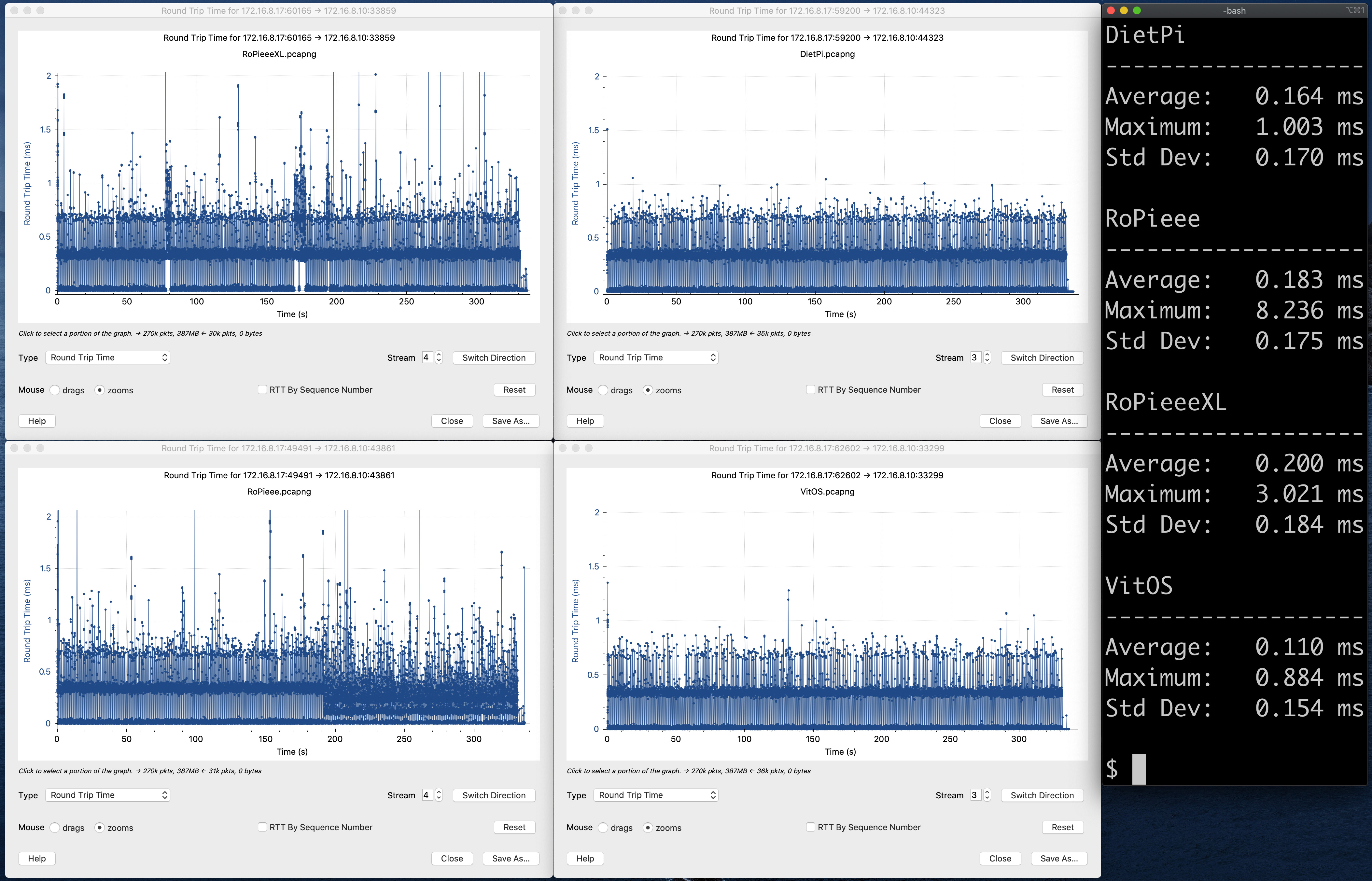

Here are some round-trip plots and statistics from Wireshark. I collected these while playing Blue in Green from Miles Davis’ Kind of Blue. This is a 24-bit, 192 kHz download from HDtracks.
Again, I don’t understand why there would be a correlation between lower endpoint latency and subjective sound quality, but Silent Angel at least does what they claim to do regarding network performance. And, VitOS does sound better to me, for whatever reason. :slight_smile:
Great explanations, Mike!
I’m also interested in why latency would matter. I mean, bits are still flowing in order they are sent, just slightly delayed, I think?
I could see lack of other background processes causing an improvement in sound quality. And VitOS does indeed do that.
Wondering what some of the other processes that run. Specifically the “lighttpd-angel” tasks.
Anyone do a network analysis of where data is going? Anything funky?
I still have my pcap traces. I’m 99.9% certain that the lighttpd-angel process is there to respond to the mobile app. All of the code for the app seems to have been written in Bash. Unusual choice, but I guess it works. I’ve not seen anything sinister in there so far.
