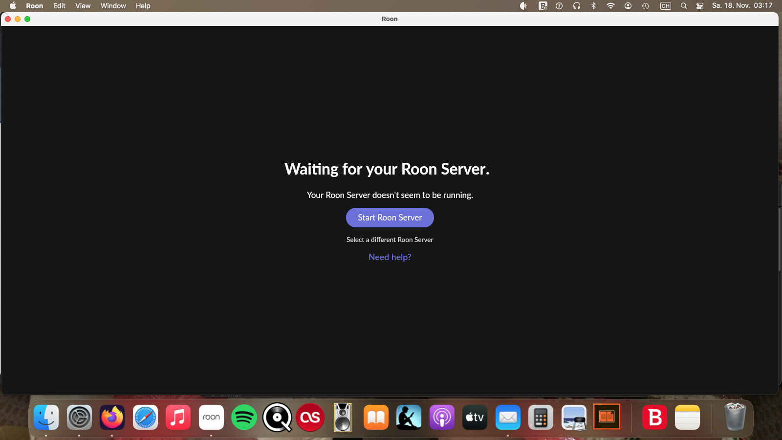

After the last update to version 2.0.5 i’m stuck on the screen “Waiting for your Roon Server.” Switching off firewall and antivirus software and a fresh installing of Roon did not help.

Hello @benjamin
The problem is still here. Here you see the screenshot:
In your second to last post you asked me, what the status of the server in the menue bar was: It says: running.
Wheter a fresh install nor a hardwiring to the router were of any help to the problem.

What happens if you click the “Select a different Roon Server” shown in your screenshot? Does it find the running Roon Server on your Mac?
Hello @Geoff_Coupe
When I do something on this page, I always fall back on this page again without an results.
