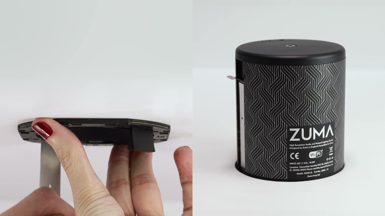

My primary interest was in the lighting side of this product - it is as advanced as the sound. I installed multiple units in a project that took 7 months. You can buy one unit, expand an existing LED hole to 95mm, connect the supplied 24v transformer to the existing lighting circuit and install the unit. That can be done in a few minutes. It has a patented system to fix the unit in the ceiling so that it can play very loud without rattling (it is screw tight), but can be removed equally quickly without causing any damage. The software will connect the unit in a few seconds.

One of the main features is that it is incredibly cost-effective, much cheaper than putting in something like Lightewave + Sonos, and infinitely better. It is designed to be self-installed, because all you have to do is attach a 24v transformer to the existing lighting circuit. My electrician installed all 50 transformers in half a day. I was going to put the units in myself, ultimately Zuma came round as it was a large installation and they offered to assist. This is how easy it is.
Each unit only draws about 8w, so on one circuit I have 22 units on a ring connected to a single rocker switch. In the image below there are about 16 speaker/lights and about 10 more light units.
