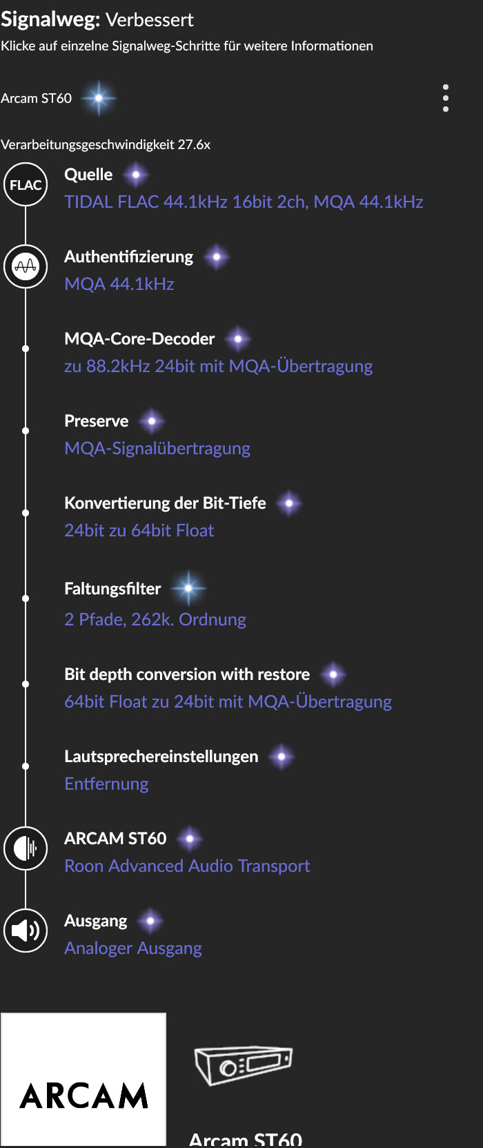

When no DSP is activated then the Arcam shows MQA or MQA Studio in the display.
With DSP it’s always RoonReady with the samplerate of the first unfold of Roon, but I hope in the background it will do the second unfold
And without DSP:

With DSP you need it set as renderer only and Roons MQA decoder should do that first part and maintain MQA signalling.
Hi @Simon_Arnold3,
One could but only if one wishes to force Roon to always perform the MQA decode.
When a Roon zone is setup for an endpoint that supports MQA Decoding and Rendering … Roon is smart and knows when to engage its MQA decoding dependent on if DSP is in use or not.
The signal paths that @Maddin has posted demonstrate this, and all looks well.
I don’t see the MQA Rendering in the Arcam show up though in his example with DSP, it should still show up should it not?
Hi @Simon_Arnold3,
Roon Ready MQA DACs that can decode MQA report that back to Roon, but I don’t believe that is the case when they only perform rendering … I can’t recall a DAC reporting back to Roon that it is performing MQA rendering.
I’ll have trawal in the Show us your signal path to see if there are any examples. Perhase others can confirm or otherwise … happy to be corrected on this (I may have just missed them).
Reported or not by the DAC, Roon is doing the right thing, supplying the DAC with either:
  • The raw MQA signal (No DSP, DAC supports MQA decoding)
  • The decoded MQA signal (DAC does not support MQA decoding)
  • The decoded, DSPed and preserved MQA signaling (DAC supports MQA rendering)
  • The decoded, DSPed (DAC does not support MQA rendering)
… after that it’s all down to the DACs capabilities.
