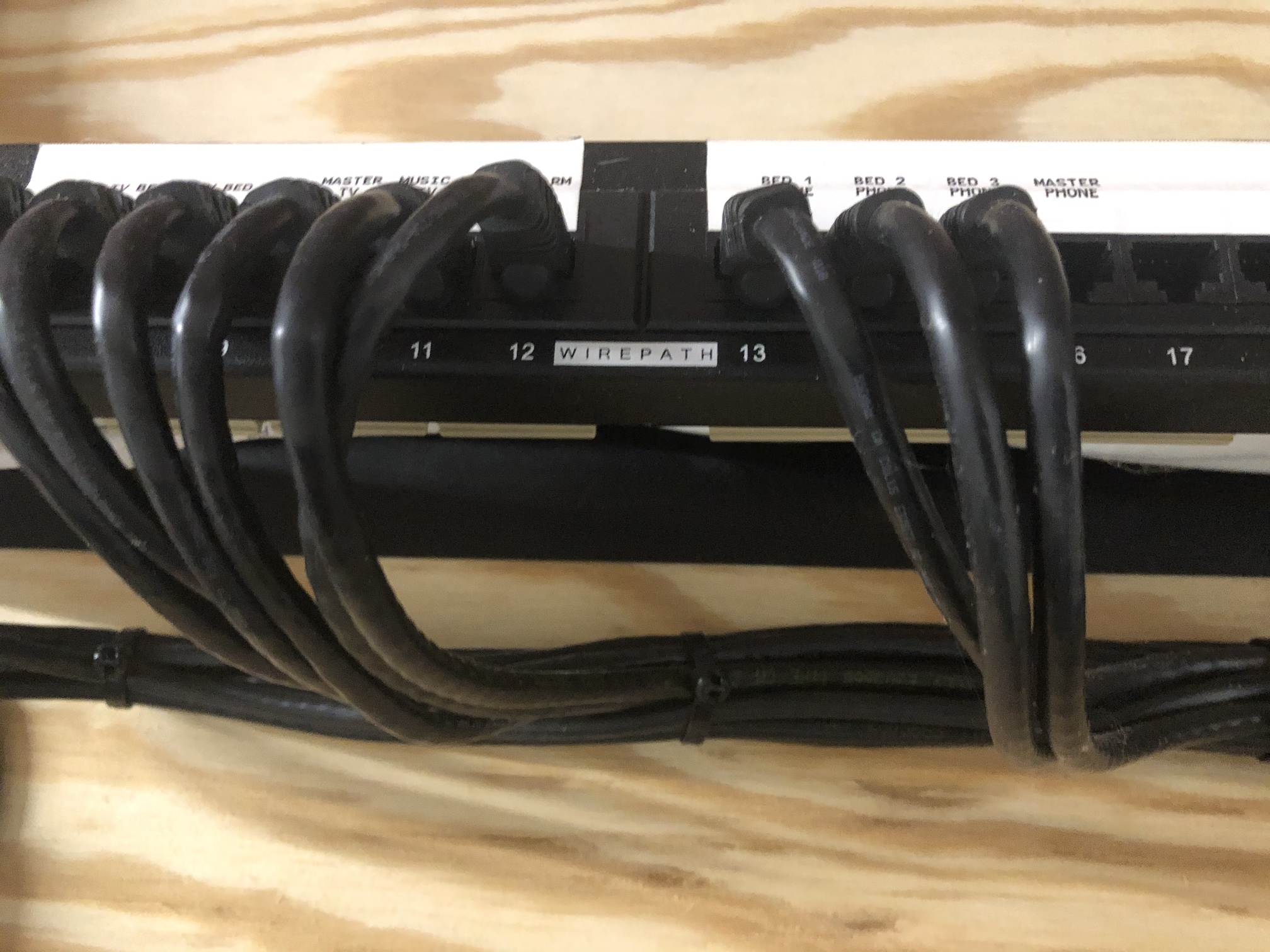

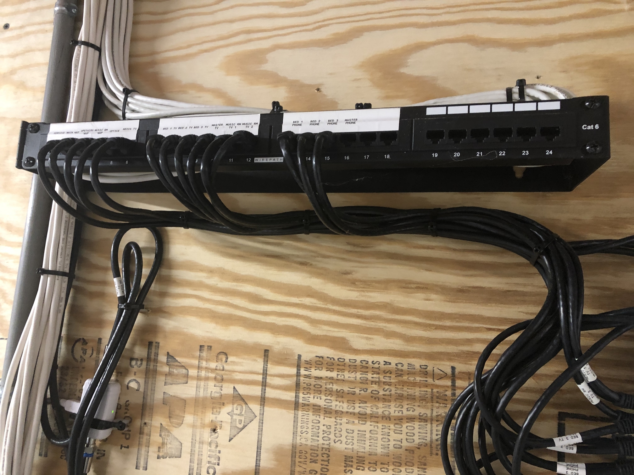

So, I didn’t know what you were asking for with a Network Map, but hope that this is it. If not, please just let me know and I will provide that information so long as it doesn’t compromise my network security.
Note also that the connection to the Lampi is via wired ethernet, NOT via wifi.
