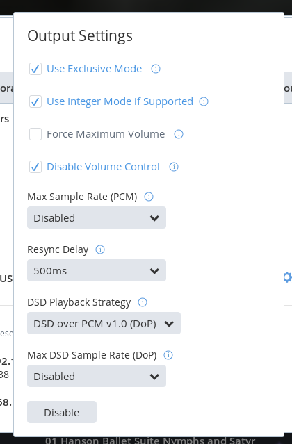

Is Max DSD Sample Rate (DoP) in your Output settings set to “Disabled” ?
yes…it is set to disabled…but the signal is being converted to PCM…DSD64 and DSD128 comes through as DSD64 and DSD128…only DSD256 seems to be converted

We don’t support DSD256 over DoP yet–Roon only does DSD256 output in native mode (meaning, on Windows using an ASIO driver).
The main barrier is: we haven’t got a piece of hardware in our test lab that supports that configuration. DSD256-over-PCM requires a DAC that supports 768khz PCM input–these are pretty rare.
Once we get our hands on some hardware, we can validate/test this configuration and then enable it in Roon.
We’ve reached out to iFi in the hopes of starting a discussion and certifying their products for use with Roon (including DoP for DSD256 content).
We’d love to work more closely with iFi, and we’ll update everyone when we have some news. If you’re an iFi customer, make sure you let them know you’re using Roon, and that further collaboration between the two companies is important to you.

We are using 1.1 as specified here, but have not enabled sending >DSD128 over DoP.
We understand the principle behind how DoP works at DSD256, it’s not really a technical problem. This is a support/QA problem, primarily. It’s difficult for us to release a feature that we cannot test or support. We are working on getting hardware.

These are my settings:
