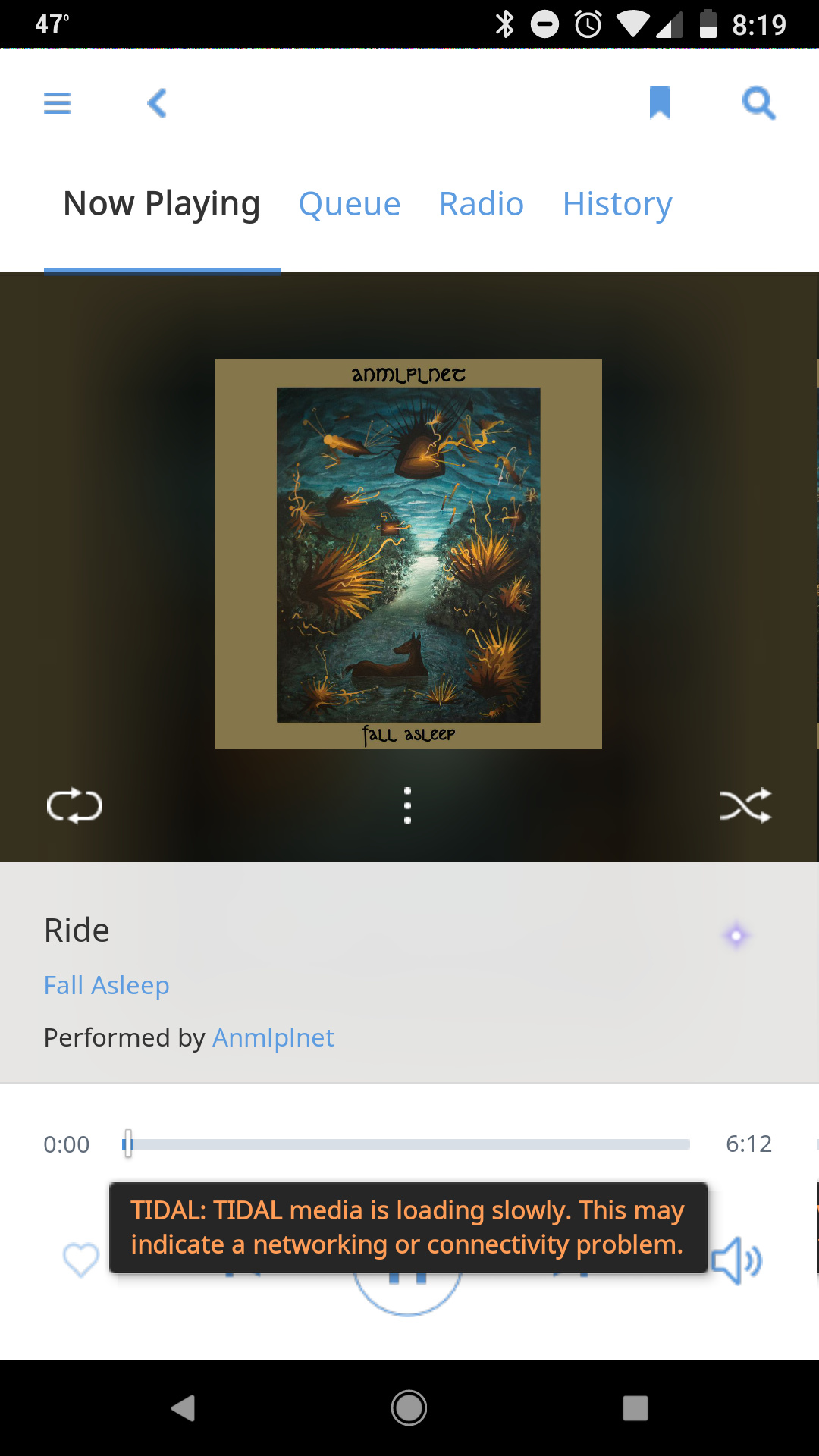

Problem:
“Tidal: tidal media is loading slowly. This may indicate a networking or connectivity problem”, track skips.
I can’t get through an album without interruption. It’s very frustrating and why I cancelled a year ago, but forgot before subscribing again last week.

Basement system connected to the core does not skip. Main system upstairs skips. Bubbleupnp has been disconnected since trying to troubleshoot but never had problems. When playing a core local file to the allo upstairs I get this message:
