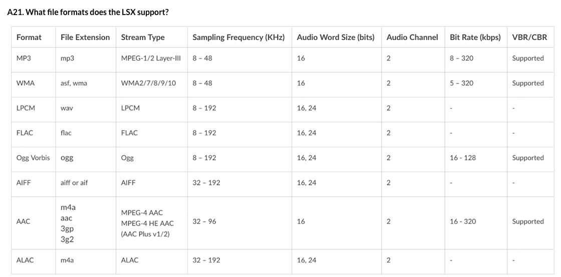

Just bought a blue pair of KEF LSXs (20% off at Superfi, Birmingham end of lease sale). Initially I had an issue in Roon with a long lag before playing files then some stuttering during playback. I reset the Roon software and everything was fine with 192kHz files being downsampled to 96kHz (I have connected the speakers with an ethernet cable). Yesterday I had to unplug everything as I bought a new extension lead and since then, even with resetting Roon, it won’t downsample 192kHz files and tries to play them resulting in a stuttering every few seconds (I also restarted the Nucleus). No issues streaming Tidal through the KEF Stream app as these are HiFi and not Master files.
Any suggestions?
Think it’s a Qobuz thing as it’s not supported by the KEF LSXs although will play less high quality files with no problems. Tidal 192s are correctly downsampled through Roon to the the appropriate frequency. Perhaps a good reason to discontinue Qobuz and carry on solely with Tidal (please see my other topic on this).
Did you try to limit playback to 96khz in roon advanced settings for the LSX ?
Just tried now. In Qobuz the signal path shows the downsampling but still the stuttering so basically unplayable. In Tidal it automatically downsamples on the signal path and plays fine. I wonder if it is anything to do with the FLAC file? This is showing my ignorance but e.g. for one album Qobuz is FLAC 192kHz 24 bit and Tidal is FLAC 48kHz 24 bit, MQA 192kHz?
But … just playing JB-Radio 2 through Roon and KEF LSX and the source is FLAC 192kHz 16bit 2ch with no stuttering. Also, playing Linn Jazz Radio the Roon interface suddenly disappeared from the screen but the music keeps playing. The only way to get it back is to turn off the speakers.

Hi. Using Diana Krall ‘Turn Up The Quiet’ FLAC 192kHz 24 bit on Qobuz as an example album. It already was on the maximum sample rate (192). When I put it to 96 it stuttered but less (NB. I am not running an ethernet cable between the speakers), but at 48 it was perfect. On both 96 and 48 the signal path showed it was downsampling, on 192 there was no down sampling i.e 192 straight to KEF LSX. Playing the same album on TIDAL FLAC 48kHz, 24 bit MQA 192 kHz no issues with downsampling on the signal path. So I am assuming using the Qobuz album the speakers cannot handle the FLAC at 192kHz (probably it would handle FLAC 96 if I had connected the speakers with an ethernet cable) and with my limited knowledge I am getting confused between TIDAL MQA 192 kHz and Qobuz FLAC 192 kHz. So it would seem from this the speakers will not play FLAC 192 kHz properly BUT when I listen to JB Radio 2 it plays perfectly FLAC 192 kHz 16 bit with no downsampling on the signal path. So by a process of elimination it must be that the Qobuz FLAC 192 kHz is the problem. Still can’t work out why the FLAC 192 is working with the internet radio station.
