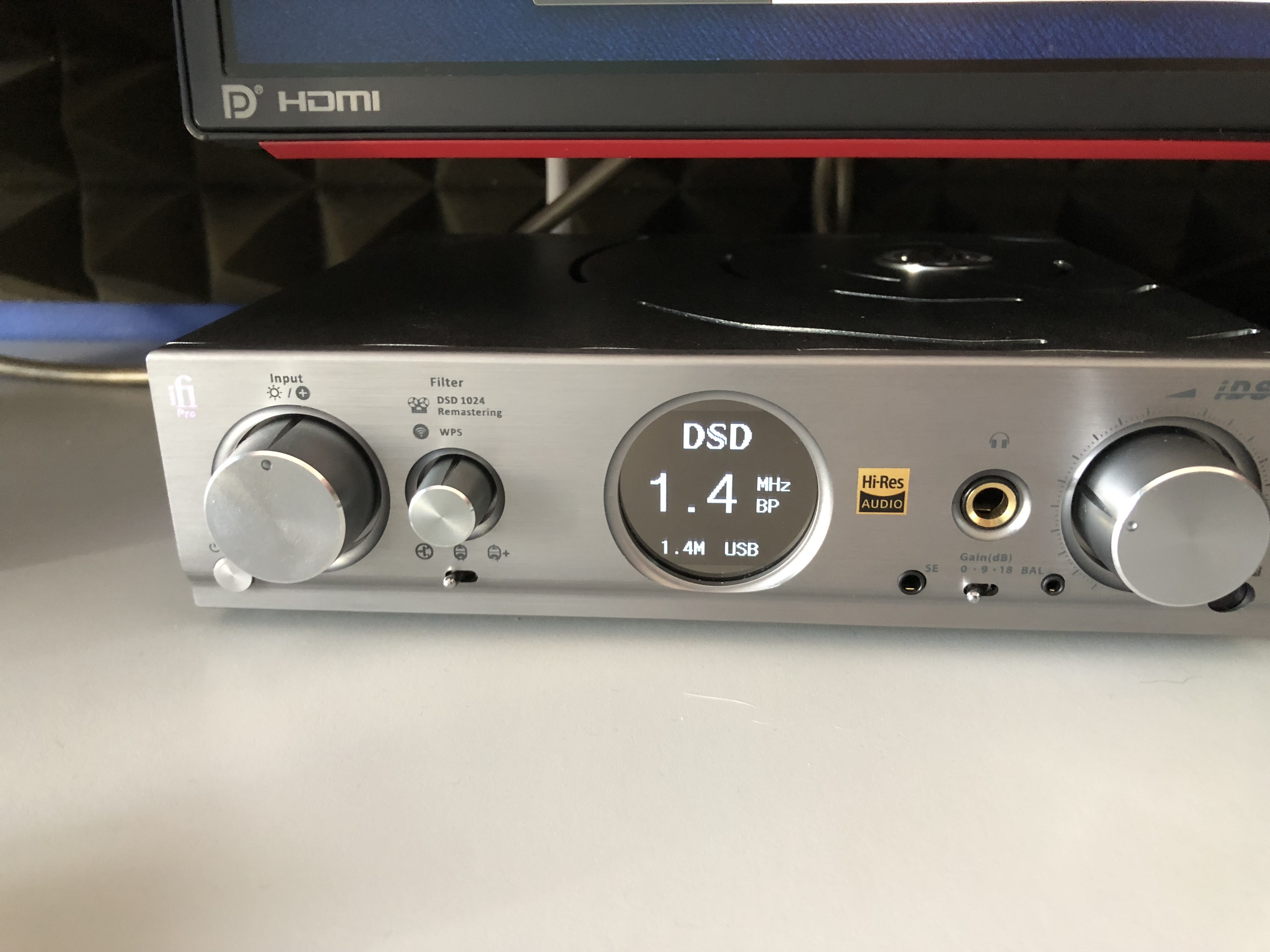

But connected at the computer changing track formats the 1.4mhz appeared on the DAC and this one is very noisy, photo taken at 16h.51 greenwich meridian time.
I have to add that this issue is only present as a Roon endpoint with SOTM, DLNA does not have this issue.
