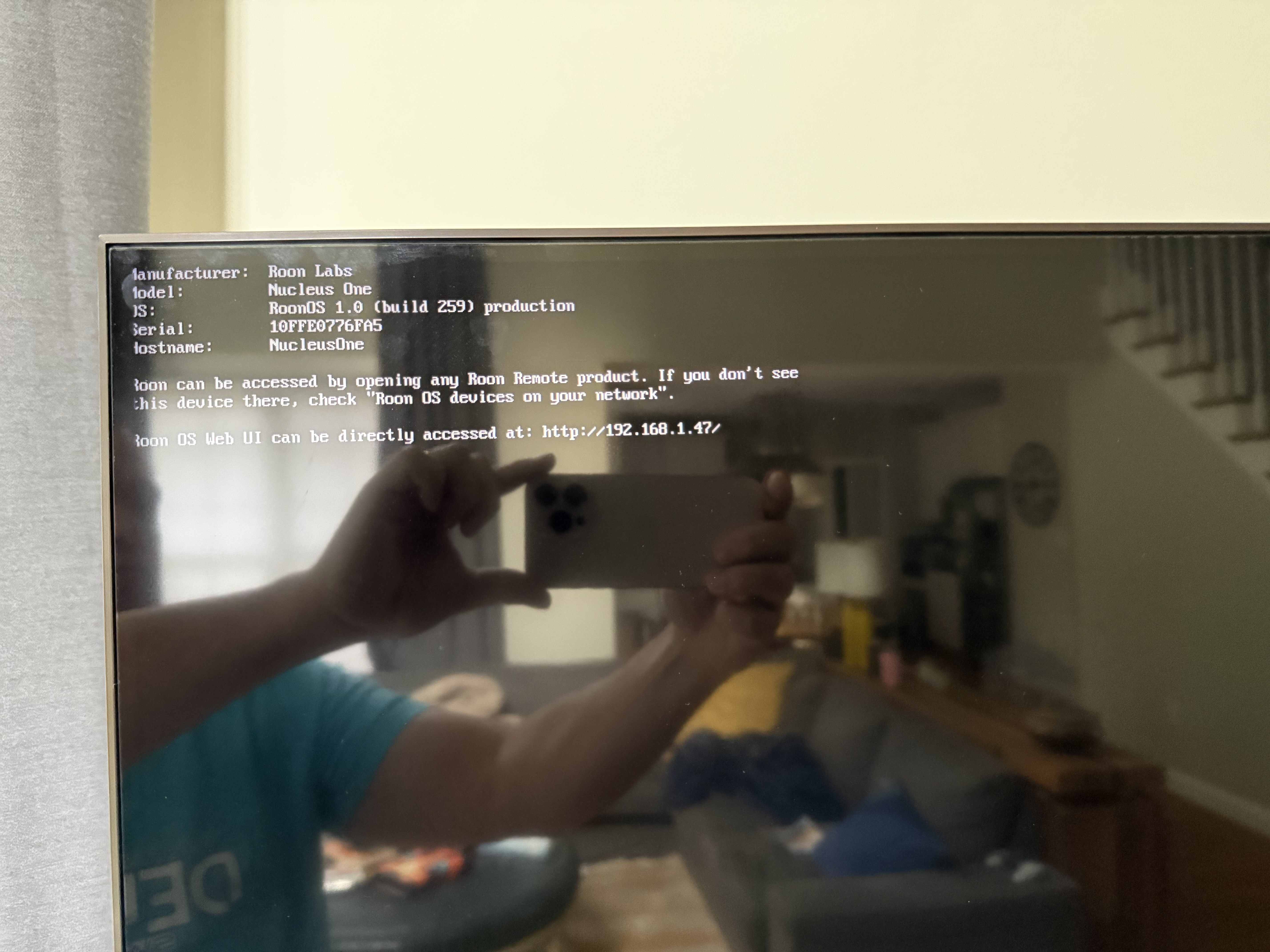

Also, try connecting the Nucleus to a TV or monitor via HDMI and share what appears on the screen. If you can take a picture of it, that might give us more insight into whether the system is booting correctly or if there’s an issue with its network visibility.
Connected via USB. I hooked up to TV and it booted fine, I visited the UI and everything looks ok. Roon server sees it again, I use the app on my phone to play and it plays, just nothing coming out of headphones. I also tried connecting direct to my amp and server and app still see it and looks like it is playing, still nothing out of headphones. I tried a different set of headphones just in case that was the issue to no avail. Note, when plug in to my DAC, I can tell there is a connection due to the YGGDRASIL making the noise and the lights coming on. Is there possibly a setting in the device settings I am missing?

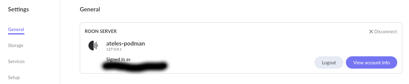

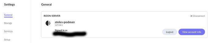

Please go to Roon → Settings → General, and share a screenshot. It should look similar to this.
You should see the Nucleus One listed under Roon server.

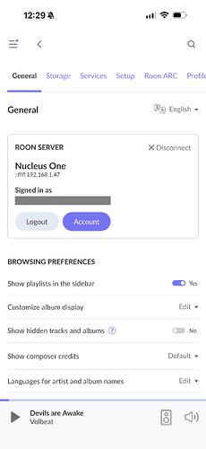

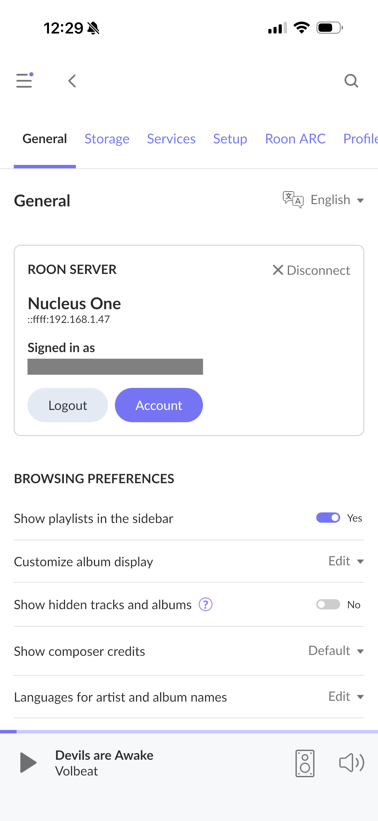

Can you provide a screenshot of what is shown for the Roon Server under Roon settings → General? If it shows your Windows 10 machine there you can click “Disconnect” then you should have the option to connect the Nucleus One.
sorry, I thought I already did this . [moderated - email address removed]
Hi @Richard_Wolfington,
Thanks for sharing the screenshot! Everything looks ok to that end…a small side test (and my apologies if this has been glazed over) but are you able to stream audio from the system output of any of your remotes, like your Windows 10 or mobile device?
