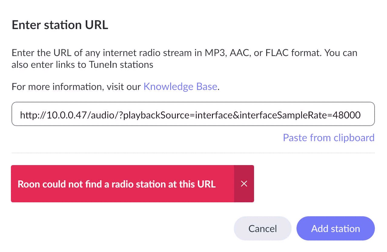

Am trying to get this MiniDSP product to work with rooPlay. It says it is Class 2 audio and is compatible with Linux. https://www.minidsp.com/products/usb-audio-interface/mchstreamer-box
I have plugged into into a USB hub which is plugged into the rooExtend box USB port. When I look at the rooPlay settings there is no option for Audio Interface. I have restarted the rooExtend box after USB is plugged in and resarted Roon.
OK. So, I got rooPlay to recognize the device. I had it attached through a USB hub. I removed the hub and connectedt he device directly to the USB port of the RooExtend Box. However, now I cannot get it to play and cannot get it to creaat a radio station. It has a single output and I used the following URL (http://[IP number]/audio/?playbackSource=interface&interfaceSampleRate=48000), inputing the correct IP number in place of [EP number]. But i get an error back that it cannot “find radio station at this URL”. I was successful at setting up the roonPlay station for Bluetooth.

If the steamer is USB Audio Class 2 it should work also with a USB HUB. Please make sure you use a self powered HUB with it’s own power supply.
It would be helpful for me to see the Sound interface debug output. You find it if you open a browser and ether the IP-Number of your rooExtend-Box. At the bottom of the displayed page you see this button. Click it and please e-mail the content to info@definiteaudio.de
It is the same IP-number you have to enter for the Radio Station setting.
Best DrCWO
One more thing. You must input a valid TOSLINK signal during setup of the Radio station with exactly the sample rate you specified in your URL.

Correct. That was the problem (not starting the stream before creating the station). I started playing the stream and now the radio station can recognize it. However, unlike the station I created for Airplay (using rooPlay), this radio station doesn’t start automatically when I start the stream. Is there a way to have the radio station start when I start the stream? I’d like to be able to just start sonos playing and have the radio station start playing (like it does with Airplay to rooExtend).
