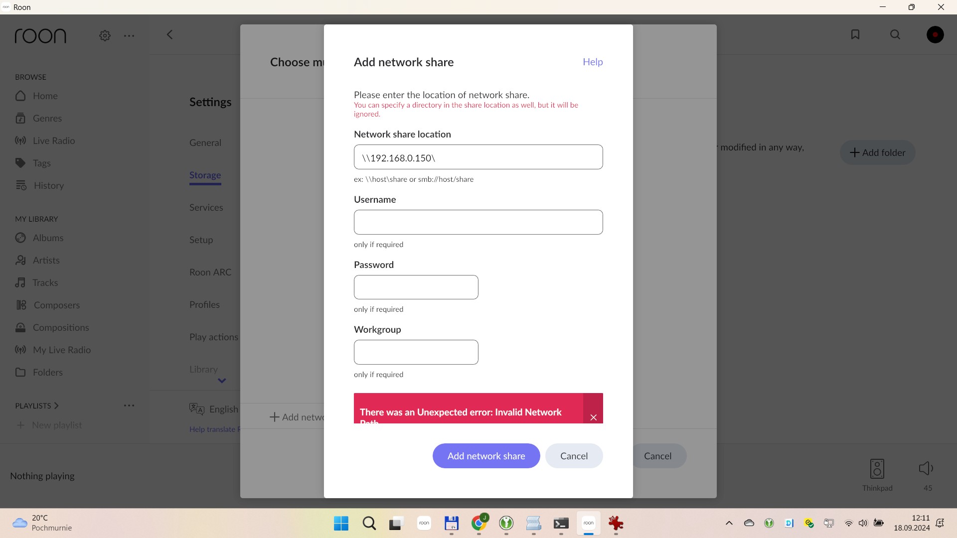

Hi, right now can’t add any folder. Can’t see. What is the correct path to Synology?
//local_ip/ ???
//Synology/folder_music_name/ ???

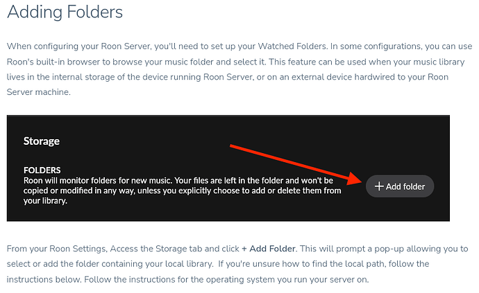

Here’s more info that may help:
Storage > +Add Folder > Add Network Share >
smb://local_ip/
using the right username and password, then pick a folder from there…
Hi,
big problem. I try smb://… enter login and pass. Nothing. Any folder. I see some bugs after change to 7.2.2 from my previous NAS DS220+. It’s possible to fix it by SSH ?

Did you install the package? Then please use local paths instead. Connecting to network shares does no longer work with DSM 7 and newer. Why even try and use network share for local folder on the same NAS (at least that is now what you seem to try)?
So then you should have been asked about where your music is (chose a folder) does this folder work for you? You should also have seen instructions about the rights you have to set on other folders on your NAS if you need Roon Server on your NAS have access to them. Please make sure you actually run the latest version of the package, compare to: Synology DSM7 – RoonOnNAS (20220216).

Your screenshot of the empty “Choose music storage folder” tells me that there is no folder with suitable access rights for the user RoonServer on this NAS.
So if done right, then something else is amiss on the NAS. But still and out of curiosity, what instructions did you follow? I hope Synology themselves can shed some light on this matter.
