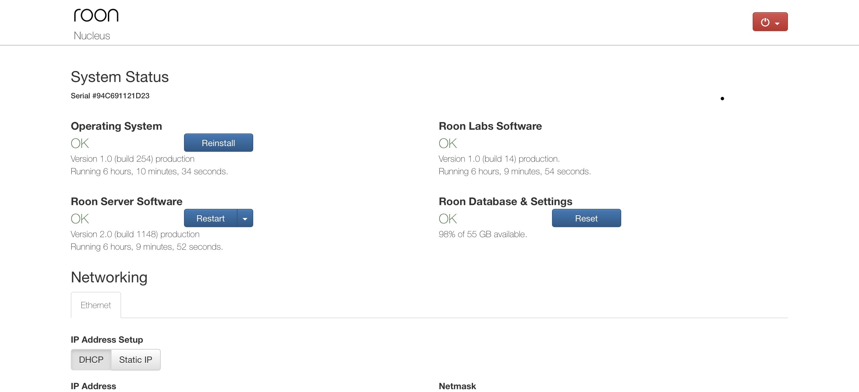

Your Roon Server version is not up to date and this is most likely the problem:
You have the outdated build 1148 and like I said:
@Wes can you please help @Amay_Villazan out and update their Nucleus remotely?
@Amay_Villazan,
Clicking on the Reinstall RoonOS icon should sort this out.
If that fails, then I’m out of ideas and it will need help from Roon.
@Amay_Villazan, this button:

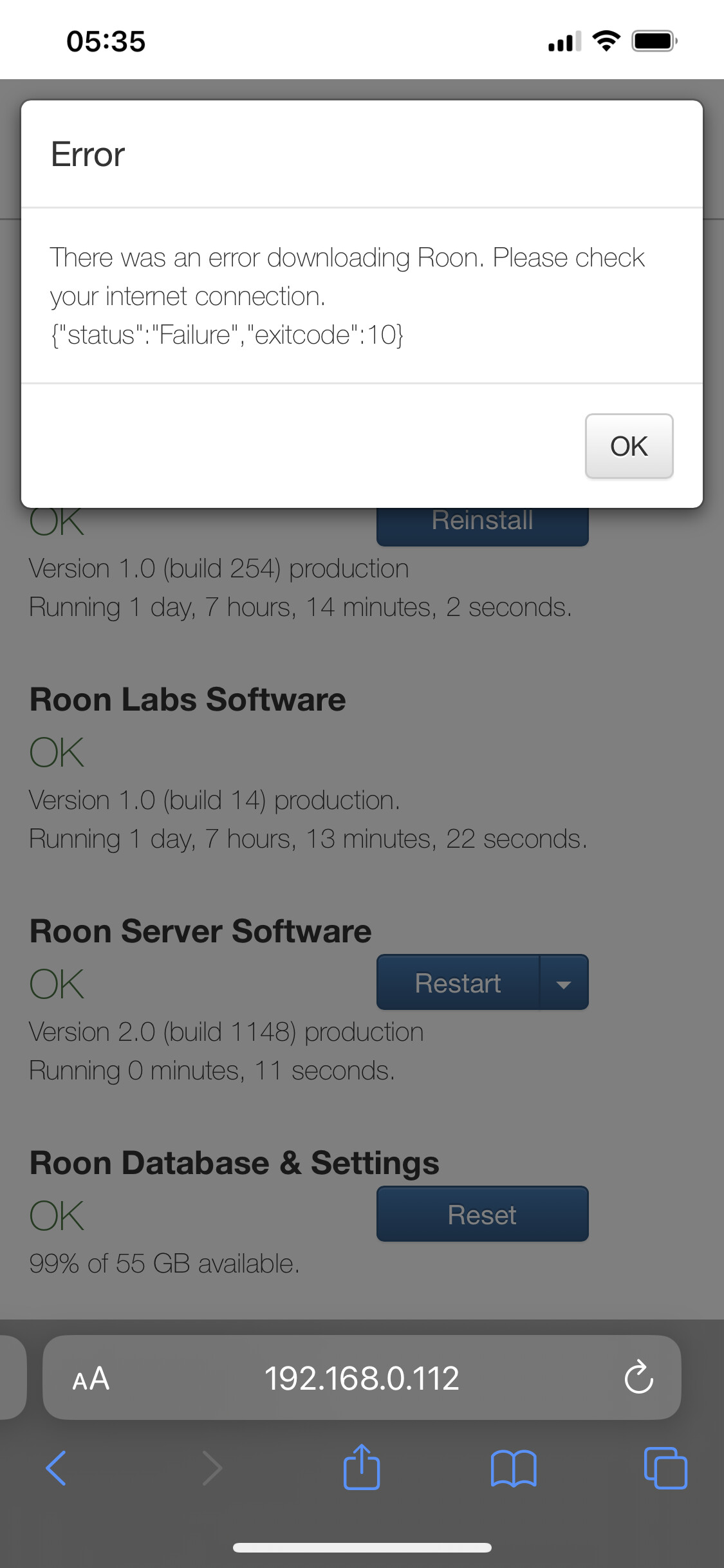

I understood but
Eek. The internet connection is OK and the Nucleus plugged in I assume?
Edit: Well I suppose it is or you wouldn’t be able to get to the web admin page in the first place. I think we are now at the point were we really need @support

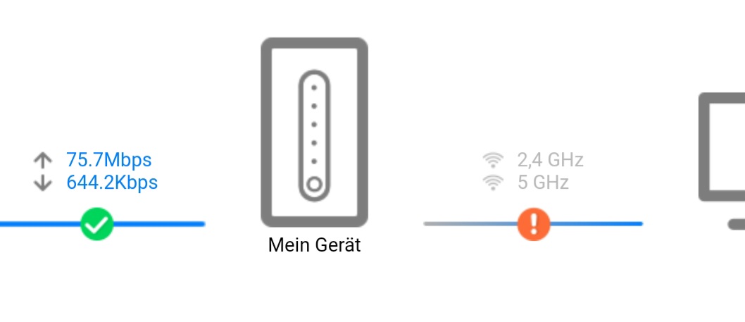

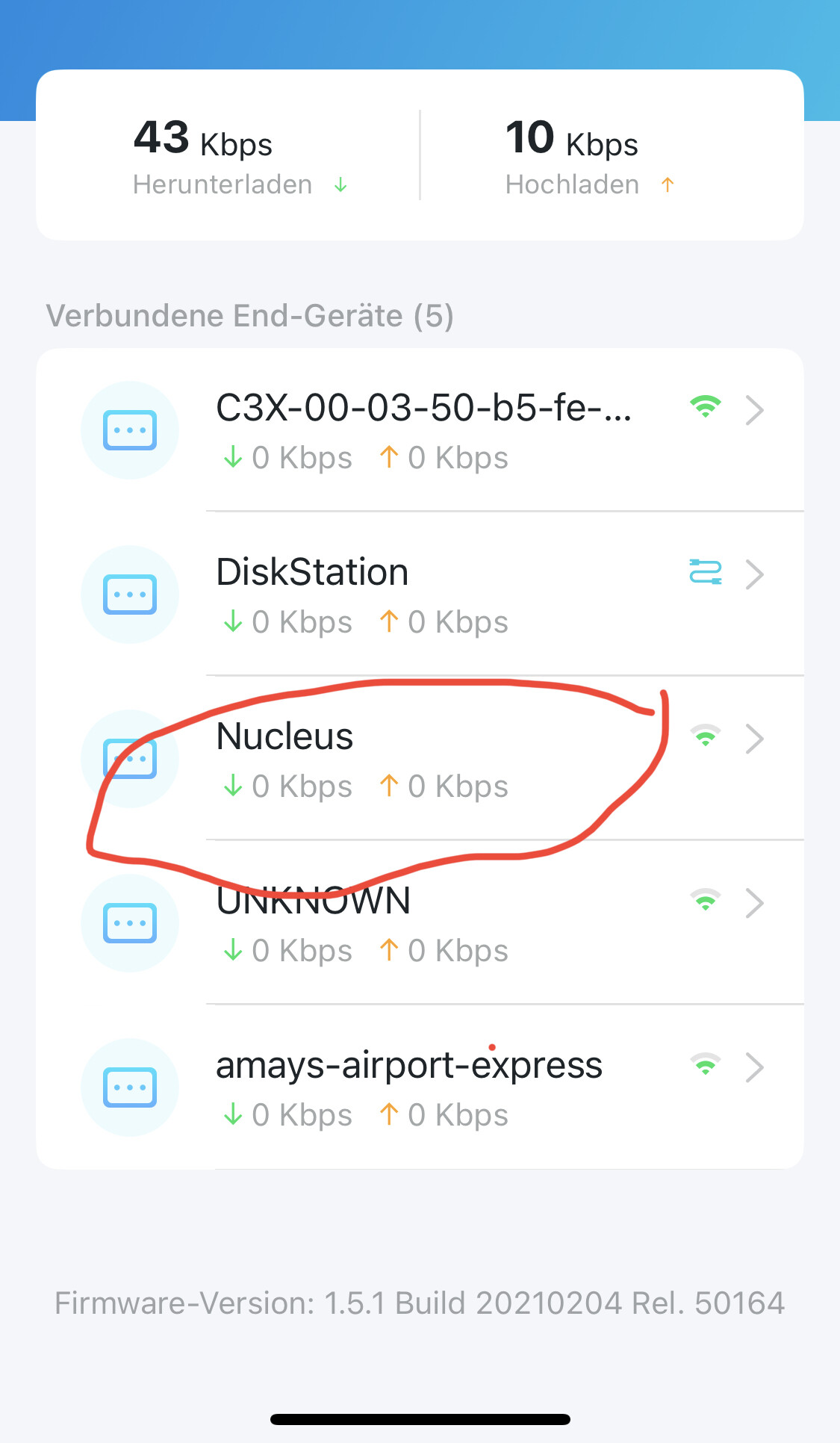

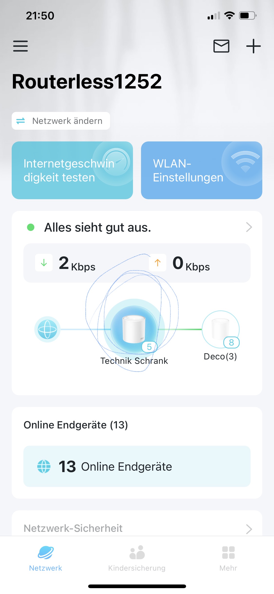

What does this does this speed refer to, circled in red? It’s ridiculously slow at 2 Kbps. That doesn’t look “all good” at all despite the app claiming it is
And these are also quite slow even for wifi
I suspect what is shown here is just the current usage, and apparently pretty much idle here. I know the same thing from my modem’s ui.
First pic is nearly idle, i’m just typing something on my phone.
Second pic shows an application running.
@Amay_Villazan
Is this correct?
Or is the throughput really that low?
If my guess is right, could you please try connecting your Nucleus to the TP-Link router with a LAN cable and see how it goes, initially without the synology storage?

Indeed, which causes the remotes crashing and should be fixed by the Roon OS reinstall, but the problem has turned into the Roon OS failing to reinstall
Hey @Amay_Villazan,
I think I can fix this but the Nucleus is showing as offline right now. Can you get it online and let me know?
