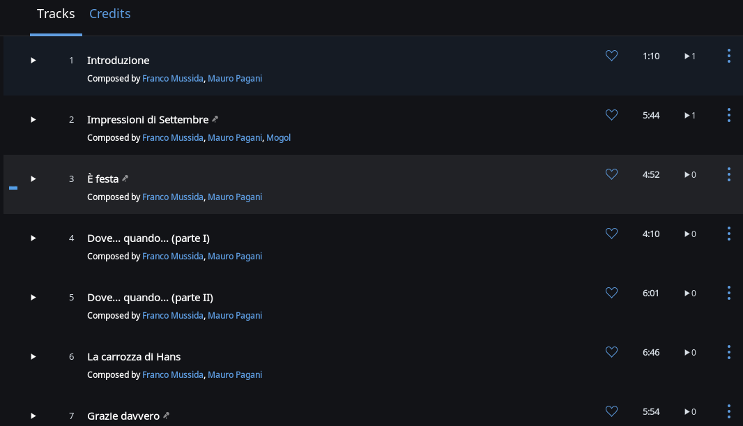

i was loiking for one example, and returning to one of the “fails” i have found out… that it worked.
maybe the problem is that i first changed the setting to “prefer file” in the multi-part section and AFTER i have populated the WORK tag (and rescan).
but it seems that the setting change takes affect only if there is a WORK tag… otherwise it reverts to “prefer Roon” (roon is the only program i know when you cannot see the apply setting, you can change the settings, but not see them!!!).
so i’ll look more deeply in other files and see if i can make this cabalistic recipe work.

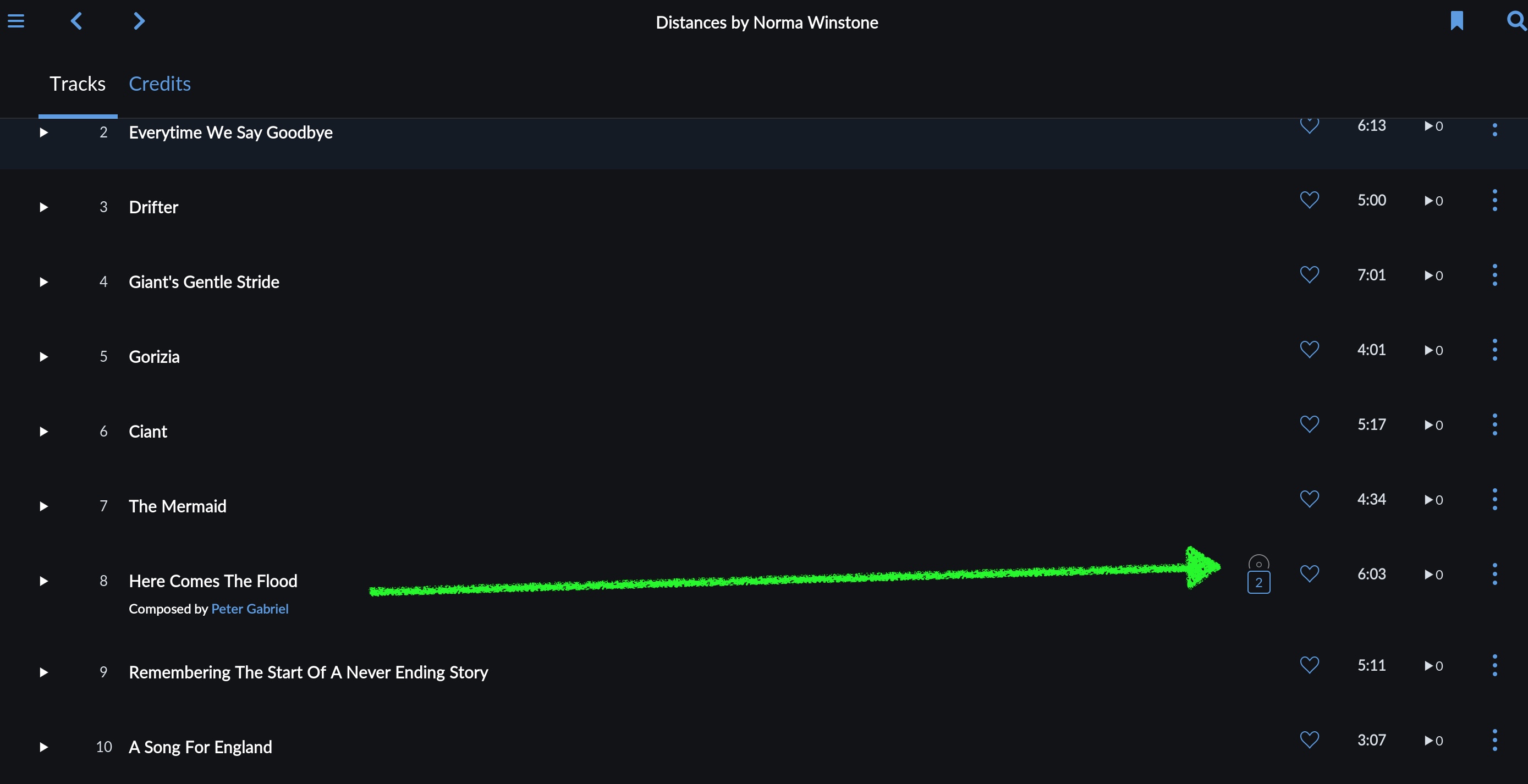

An example with which I’ve tried to reproduce what Brian described here
The album (let me know if you need a “debug copy” or if it’s available to you):
Track 8 has no composer credits (allmusic doesn’t know about it).
Now adding the composer manually …
… get’s me this:

Update: interestingly, when I look at the album properties, I see this:
I’ve applied Tony’s work/part trick … and with this I can switch it on and off.

if i can summarize the overall discussion, there are 2 scenarios:
scenario 1: import settings with “prefer roon” for multi-part. then even if you tag files with a composer (and/or a composition=WORK) tag the tracks remain “orphan” with no composition associated. composers are shown under the tracks (if settings ask to), but no more than that: added composers do not exist in the library and the links are not active. this happens not every time, but is quite likely if allmusic has only some tracks without composition.
scenario 2: import settings with “prefer file” for multi-part. then if (and only if) you add both a COMPOSER tag and a WORK tag… the tracks are associated to a composition (=WORK) and the composer becomes real in the library and the link near the tracks is active.
this second behavior is, in my (i think our) opinion, what should be considered as “normal”, whatever settings one chooses. the existence of a composition associated to EVERY track is, for some of us, something which is the real “magic” of roon: something that allows to explore our own library looking for interconnections between albums and artists.
at this point, we can say that the problem is “solved”, as the workaround in scenario 2 seems to work. at the moment, i’m going through a massive tagging task to add the WORK tag to all my files (except classical music, that already has it).
